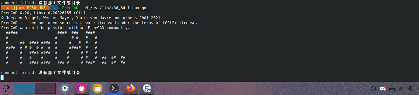

Well, I should add that it doesn't seem to be caused by a permissions issue, but rather by my accidental execution in the following path. Strange..
cd /usr/lib/x86_64-linux-gnu/
jack9603301
2021-10-18 19:22
reporter   ~0015993
The problem seems to be related to the fact that the associated dynamic libraries are not python3 working paths (such as /usr/mod)...
FreeCAD  -M /usr/lib/x86_64-linux-gnu

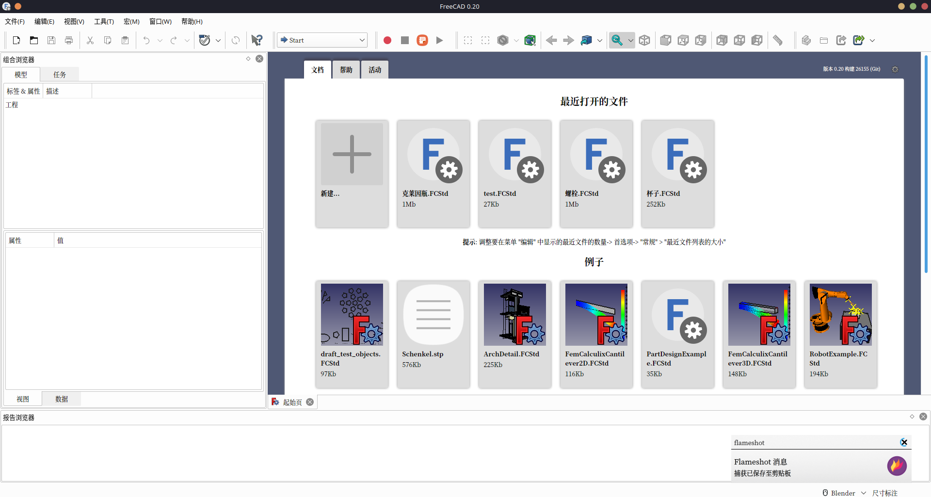

Run the following command to start:
I think this is a mistake, and if those dynamic library were in the same directory as python mods, then everything would be fine.
Perhaps the people concerned just need to modify the Cmake installation configuration to fix this error.
This problem has been tested.
Although the cause of the error was misjudged once, it was indeed a flaw in the installation process
This is not a serious error because it can be resolved by -M, but it is a defect.
