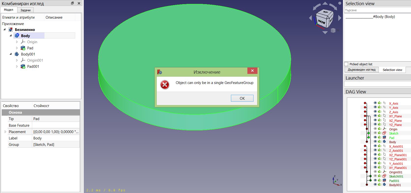

| Summary | 0004775: Duplicate object results in <Exception> Object can only be in a single GeoFeatureGroup | ||||
| Description | When duplicating a PD body object sometimes features from the newly created body are mapped to the duplicated body. | ||||
| Steps To Reproduce | Start FreeCAD. Create new Body. Draw something in a sketch, pad sketch. Select Body. Invoke Duplicate selected object, confirm dialog. Error is thrown: and sketch from the second body is mapped to a plane in the first body. | ||||
| Additional Information | Forum thread | ||||
