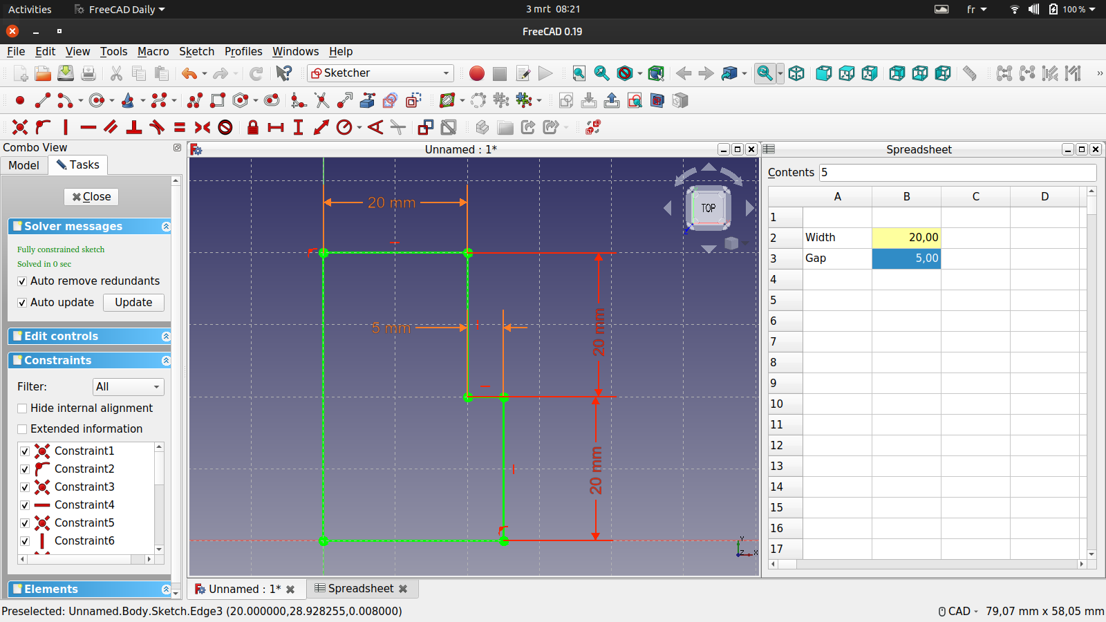

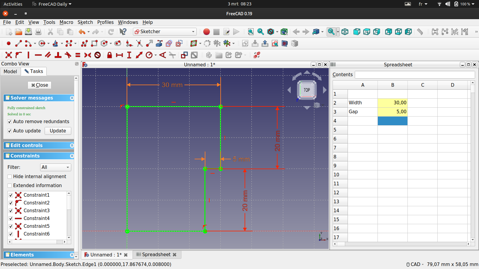

| Summary | 0004279: A sketch appears to be fully constrained but sometimes a constraint flips | ||||
| Description | In occasions I notice how a chain of horizontal or vertical constraints appear to be fully constrained. But after changing parametric values (spreadsheed), suddenly a point flips from left of the previous point to right of it. All constraints are still met (all the distances are correct) but one constraint changed direction/orientation. Maybe a horizontal/vertical constraint could also add a "fixed orientation" check-mark. Workarounds are available, making this non-critical. My basic frustration/bug is that a sketch appears to be fully constrained (green lines) while in reality it isn't. It's not possible to slide any element of the sketch to a different position but different positions are possible to reach this point. | ||||
| Steps To Reproduce | Simplified example of the sketch (screenshot) are attached. Notice that I could not trigger the flip to happen predictably so this example is a mock-up. | ||||
| FreeCAD Information | OS: Ubuntu 19.10 (ubuntu:GNOME/ubuntu) Word size of OS: 64-bit Word size of FreeCAD: 64-bit Version: 0.19. Build type: Release Python version: 3.7.5 Qt version: 5.12.4 Coin version: 4.0.0a OCC version: 7.3.0 Locale: English/United Kingdom (en_GB) | ||||
All unfortunate that this is from a user perspective, it is not something that is fixable in the software. The solver provides a solution that is valid. There are the same number of constraints as parameters. It fulfils the condition of a fully constraint. In order to try to avoid flipping, the selection of the constraints used in the sketch is very important. Experienced users in the help forum are an invaluable source of wisdom regarding this topic. |
Fully constrained doesn't mean unique. There is no continuous transition from one solution to another though. Everything works as designed. If you would have followed the extra big banner asking to open a forum discussion before opening a ticket, we could have explained this immediately. |
