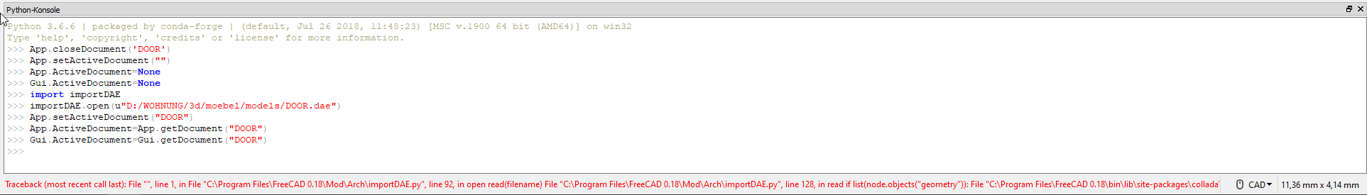

| Summary | 0004323: Import of any .dae (Collada)-file fails | ||||
| Description | According to https://wiki.freecadweb.org/index.php?title=Extra_python_modules#pyCollada FreeCAD on Windows should be able to open/import .dae-files Quote: 'Windows On Windows since 0.15 pycollada is included in both the FreeCAD release and developer builds so no additional steps are necessary.' Nevertheless every import of .dae-files (Open as well as Import) fails (see screenshot attached). If somebody tells me where to find the errormessage at the bottom of the screenshot, I could provide it. | ||||
| Steps To Reproduce | open/import any .dae-file | ||||
| Tags | #post-to-forum, 0.18 | ||||
| FreeCAD Information | OS: Windows 10 Word size of OS: 64-bit Word size of FreeCAD: 64-bit Version: 0.18.4 (GitTag) Build type: Release Branch: releases/FreeCAD-0-18 Hash: 980bf9060e28555fecd9e3462f68ca74007b70f8 Python version: 3.6.6 Qt version: 5.6.2 Coin version: 4.0.0a OCC version: 7.3.0 Locale: German/Germany (de_DE) | ||||
