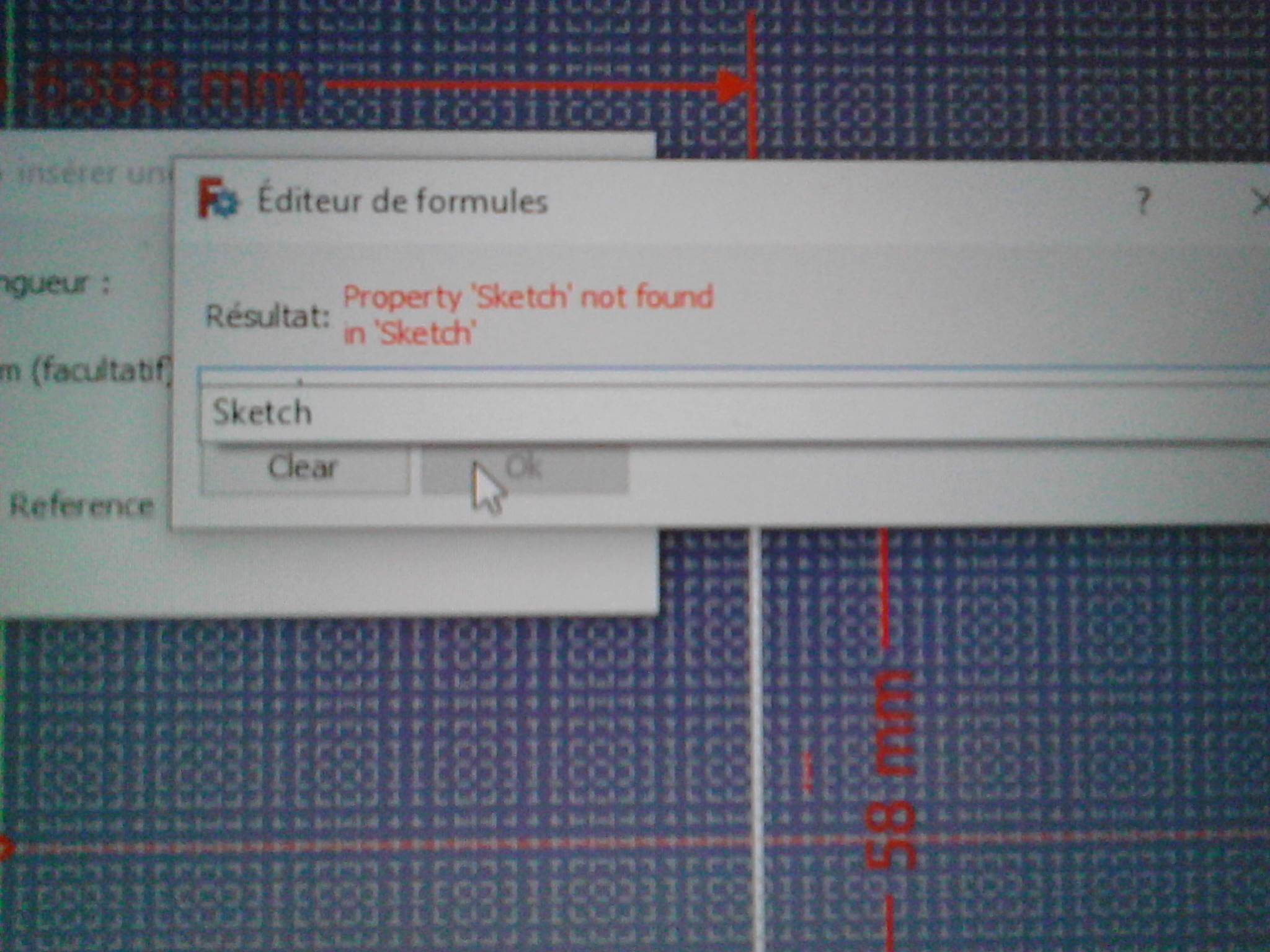

| Summary | 0004324: In expression editor in the sketcher the tooltip hides the input field. | ||||
| Description | When one want to enter an expression in a dimension constraint the help tooltip hides the text input field. I am assuming that this happens because the error message "Property 'Sketch' not found in 'Sketch'" in red takes two lines instead of one. This appens for any dimenssioning tools (vertical, horizontal, angle, radius, length). | ||||
| Steps To Reproduce | 1) Create a sketch 2) Create a line 3) Add a dimension constraint to this line and trying to enter a formula for the value. Result: during the input of the expression the input help tooltip (which lists the accessible objects) hides the input field as shown on the attachment. | ||||

|  | @lc03 : Please address your issue according our reporting guidelines by first opening a topic on our forum ("Help on using FreeCAD" subsection in English or "Forum français" in French) so community can vet the issue and narrow down the causes. Cross-link the topic with this ticket. Thx |
|  | PR: https://github.com/FreeCAD/FreeCAD/pull/3572 |
|  | git commit ac4196fb66a34cc4f246afa3c5858e6d4b821875 |
|  | Fix committed to master branch. |
| FreeCAD: master ac4196fb 2020-06-06 14:12:06 Committer: abdullahtahiriyo Details Diff | Expressions: Avoid multiline error messages =========================================== fixes 0004324 A multiline error message produces poor visualisation when used in the UI, while there is no need for it to be multiline. | Affected Issues 0004324 | |
