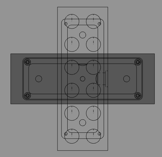

| Description | DraftWB, first added shape get flipped normal orientation when Automatic working plane and Bottom view. | ||||
| Steps To Reproduce | 1. Pref >Display >Part color >"Two-sided rendering" toggle off. 2. Restart FreeCAD, and switch to DraftWB. 3. Rendering mode >Flat lines. 4. Working plane >Automatic. 5. Change to Bottom view (Menu command "Bottom" or NaviCube "Bottom"). 6. Create a closed shape, rectangle for example. 7. Find normal orientation of rectangle get flipped. | ||||
| Additional Information | Workaround: Befor step 5, change to other view (than Bottom) and draw a closed shape. Then goto step 5. Normal of created shape at Bottom view will get correct normal. ps. This issue doesnot happen on other views than Bottom. Forum: https://forum.freecadweb.org/viewtopic.php?f=23&t=46153 | ||||
| Tags | 0.19, Draft | ||||
| FreeCAD Information | OS: Windows 10 (10.0) Word size of OS: 64-bit Word size of FreeCAD: 64-bit Version: 0.19.20514 (Git) Build type: Release Branch: master Hash: a05ffd499366ab12fa1b43f37db73f4f1e9c332d Python version: 3.8.2 Qt version: 5.12.5 Coin version: 4.0.0 OCC version: 7.4.0 Locale: Chinese/China (zh_CN) | ||||
I cought a bug that I think may be related to this one: when using bottom view or front view as direction to create Shape2DView in Draft, the projection will be rotated like attached picture. Curiously, with the bottom view, the problem only happens when using NaviCube, is View menu is used to set bottom view, the Shape2dView works fine. With front view, the problem happens both when using NaviCube or View menu. |
