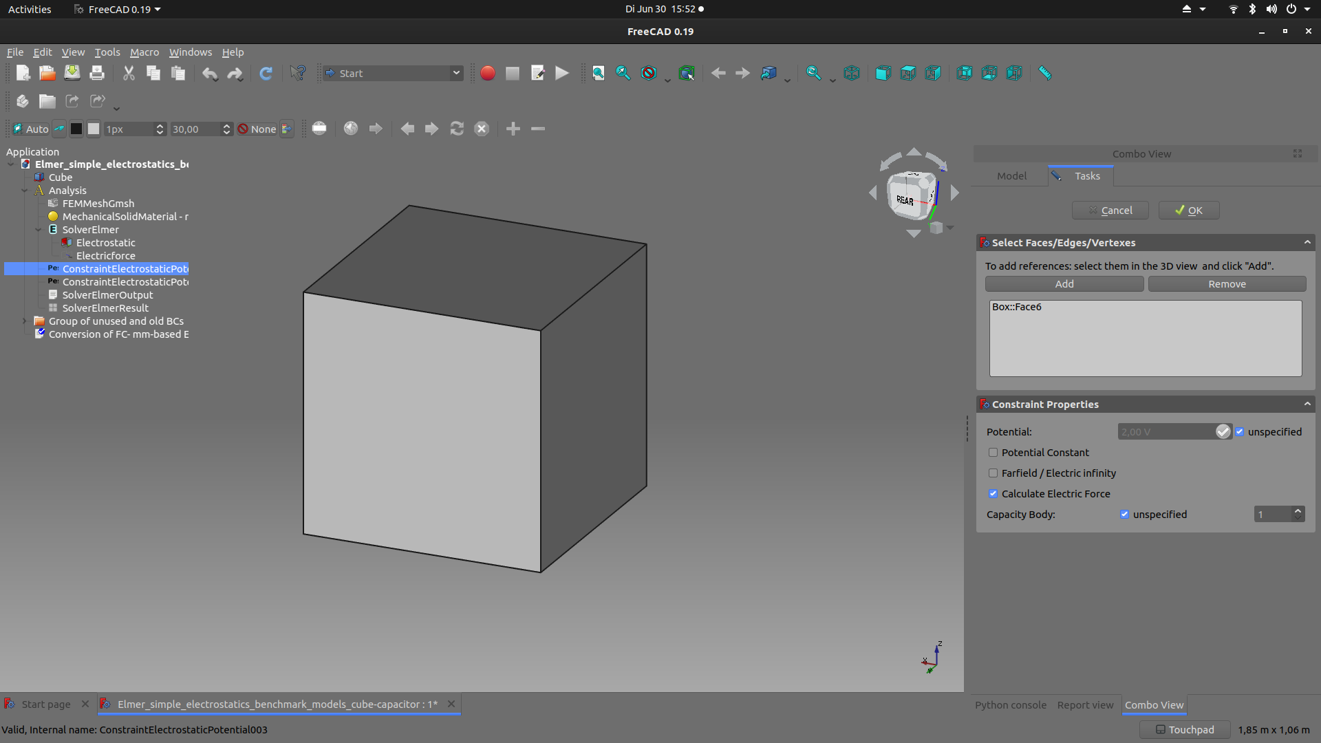

| Summary | 0004394: Clean up the ElectrostaticPotential task panel, make it smart and pretty. | ||||
| Description | The task panel for the ElectrostaticPotential setting for the Elmer solver in FEM has to be cleaned up. Currently it is very non-intuitive to use. Furthermore, some checks have to be added to enable elements like the one for the capacitance body only if the capacitance calculation is enabled in the electrostatics-solver. GUI-Elements like the capacitance body count should be disabled if the 'unspecified' Box is enabled (as done for the Potential value). https://github.com/HoWilgh/FreeCAD/blob/howilnewsolver/src/Mod/Fem/PyGui/TaskPanelFemElectrostaticPotential.ui https://github.com/HoWilgh/FreeCAD/blob/howilnewsolver/src/Mod/Fem/femsolver/elmer/equations/electrostatic.py | ||||
