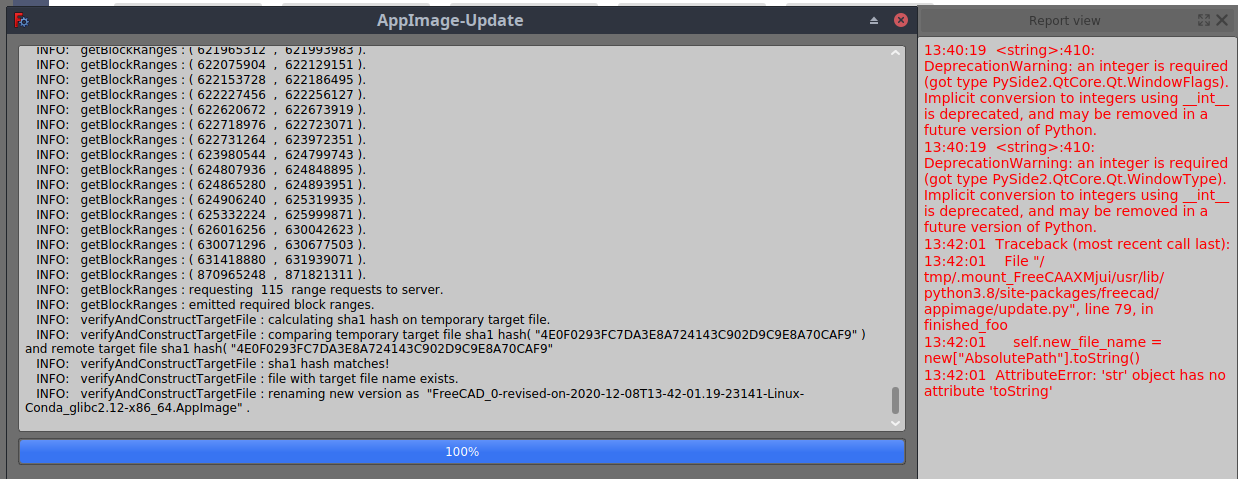

DescriptionUsing the built in AppImage updater has since a few weeks always failed at a late stage. The resulting new AppImage file is produced, but the update does not inform the user and offer to restart with the new version. The behaviour can be seen in the attached screenshot.
Forum thread with at least two users experiencing the issue: https://forum.freecad.org/viewtopic.php?f=4&t=53022
Steps To Reproduce1. Start FreeCAD 0.19dev
2. Perform AppImage update from the settings where there is an update to download
3. Select to update.
4. Towards the end of the update the python error mentioned above is reported and the update stalls, never informing the user that it completed.
