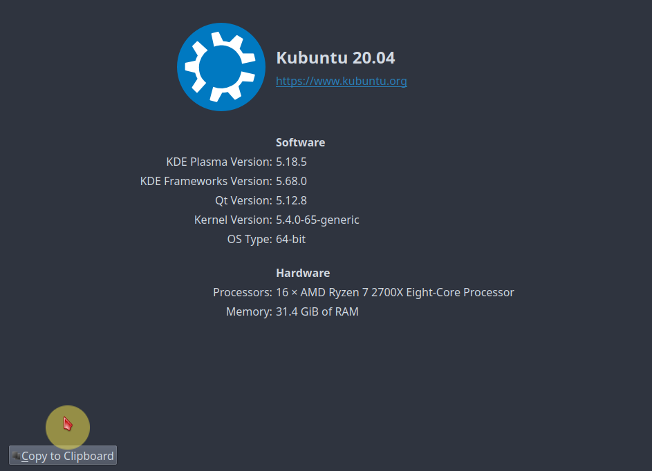

| Additional Information | I don't know if its useful but I have attached a screenshot of the versions of the graphical environment and processor that I'm using. | ||||
