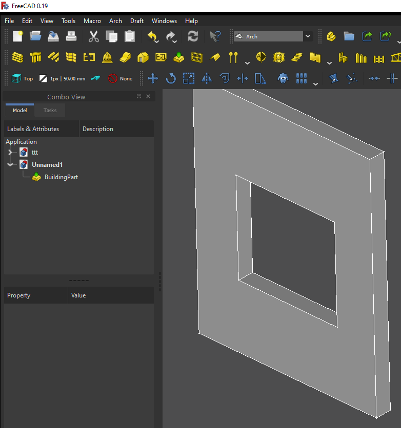

| Summary | 0004595: [Arch] Arch External Reference does not load windows nested in walls | ||||
| Description | Arch External Reference does not display windows nested in walls, inside an Arch BuildingPart, in FC 0.19 This is a regression, because the External Reference works normally in FC 0.18.4 Forum discussions where this bug is reported: https://forum.freecadweb.org/viewtopic.php?f=23&t=56467 https://forum.freecadweb.org/viewtopic.php?f=23&t=56566 | ||||
| Steps To Reproduce | -Open Arch Module. -Create an Arch wall -Place an Arch window in the wall -Put the wall in an Arch BuildingPart -Save the file. -Open a new file. -Create an Arch Reference object. -In the reference panel select the previous file and the Arch BuildingPart object. -The reference object only shows in the 3Dwindow the wall with the hole, without the window. | ||||
