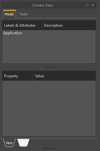

| Summary | 0004599: Build 24276 0.19 Release breaks Stylesheet theming Comboview Proprerty QTabBar theming on Windows | ||||

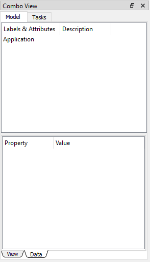

| Description | Run FreeCAD on Windows 10 with or without a stylesheet and ComboView Property [code=qtabbar::tab:bottom][/code] tabs are always old non Native OS Style tabs. Worked fine on all 0.19 pre releases. Works fine on Linux. https://forum.freecadweb.org/viewtopic.php?f=34&t=56875 | ||||
| Steps To Reproduce | Run FreeCAD on Windows 10 with or without a stylesheet and ComboView Property [code=qtabbar::tab:bottom][/code] tabs are always old non Native OS Style tabs. Worked fine on all 0.19 pre releases. | ||||
| FreeCAD Information | OS: Windows 10 Version 2009 Word size of OS: 64-bit Word size of FreeCAD: 64-bit Version: 0.19.24276 (Git) Build type: Release Branch: releases/FreeCAD-0-19 Hash: a88db11e0a908f6e38f92bfc5187b13ebe470438 Python version: 3.8.6+ Qt version: 5.15.1 Coin version: 4.0.1 OCC version: 7.5.0 Locale: English/Canada (en_CA) | ||||

Fixed in PR 4668. |
Fix merged in c:FreeCAD:04cf845d7795fdbabb04d39a60675fc50615872b |
Let's try this again: fixed in FreeCAD master 04cf845d |
Fix committed to master branch. |
FreeCAD: master 04cf845d 2021-03-25 14:34:06 Committer: wwmayer Details Diff |
[GUI] Remove explicit triangle styling from tabs On Windows the lower tabs of the PropertyView were being set to triangular, which breaks stylesheets. This removes that code, so they now take on whatever the standard shape is on the system. Fixes 0004599 |
