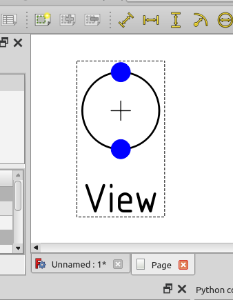

arc centres are working in v20. this is non-issue? maybe preferences issue? |
OS: Linux Mint 20.2 (X-Cinnamon/cinnamon) Word size of FreeCAD: 64-bit Version: 0.20. Build type: Release Branch: unknown Hash: f9fb1c9abb5cc357cf8f0c5d033dc52c89893ff1 Python version: 3.8.10 Qt version: 5.12.8 Coin version: 4.0.0 OCC version: 7.5.2 Locale: English/United States (en_US) |
