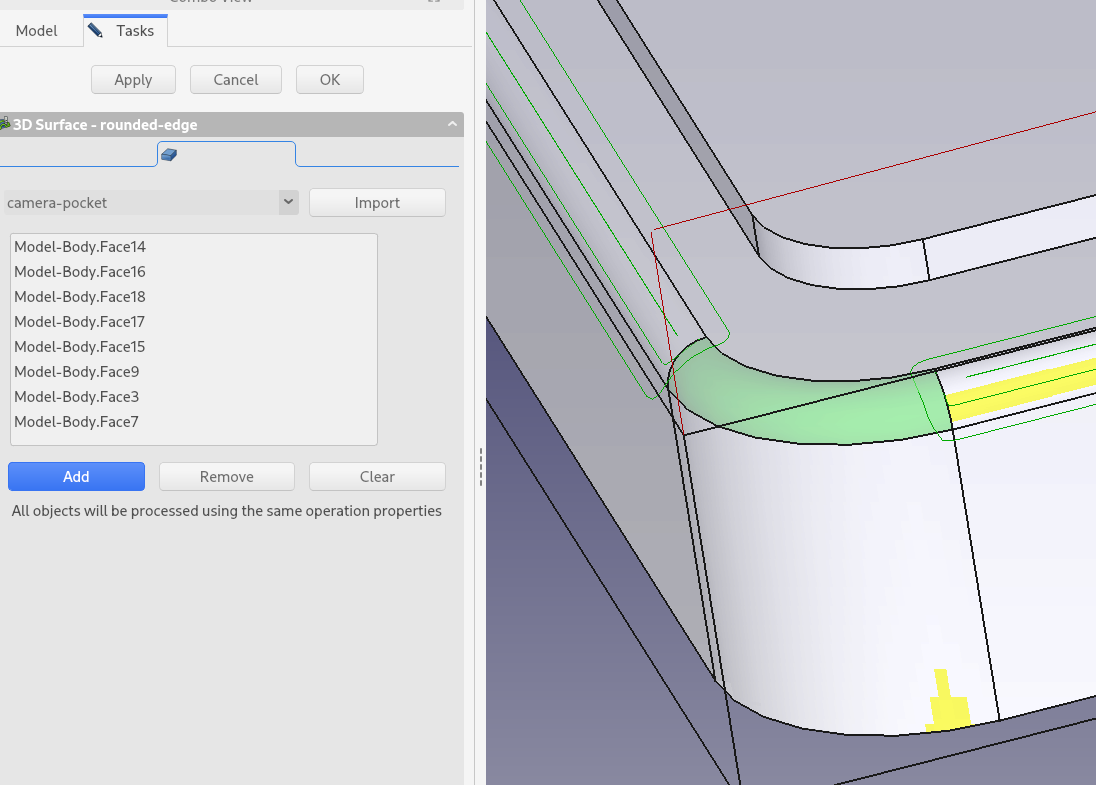

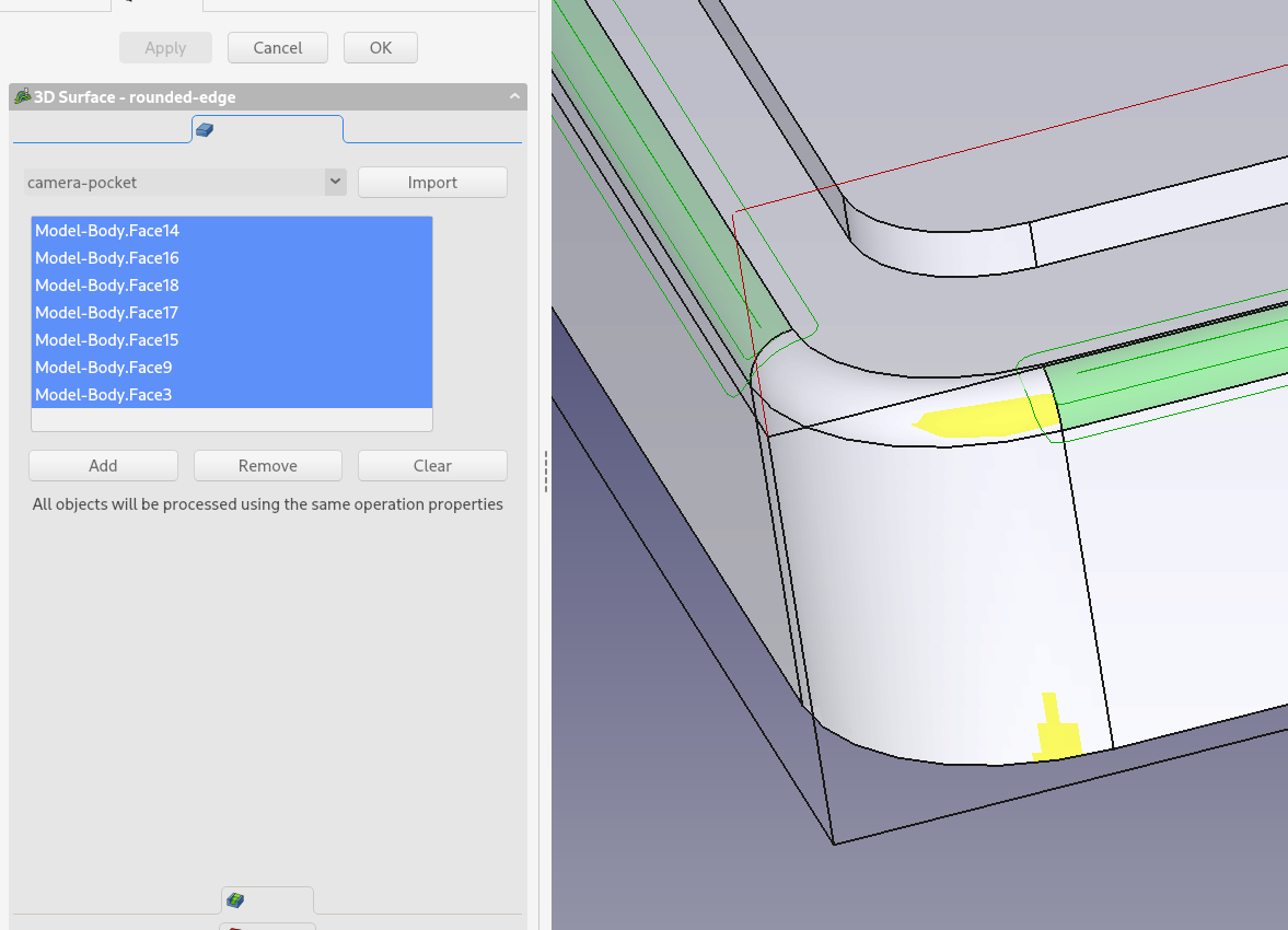

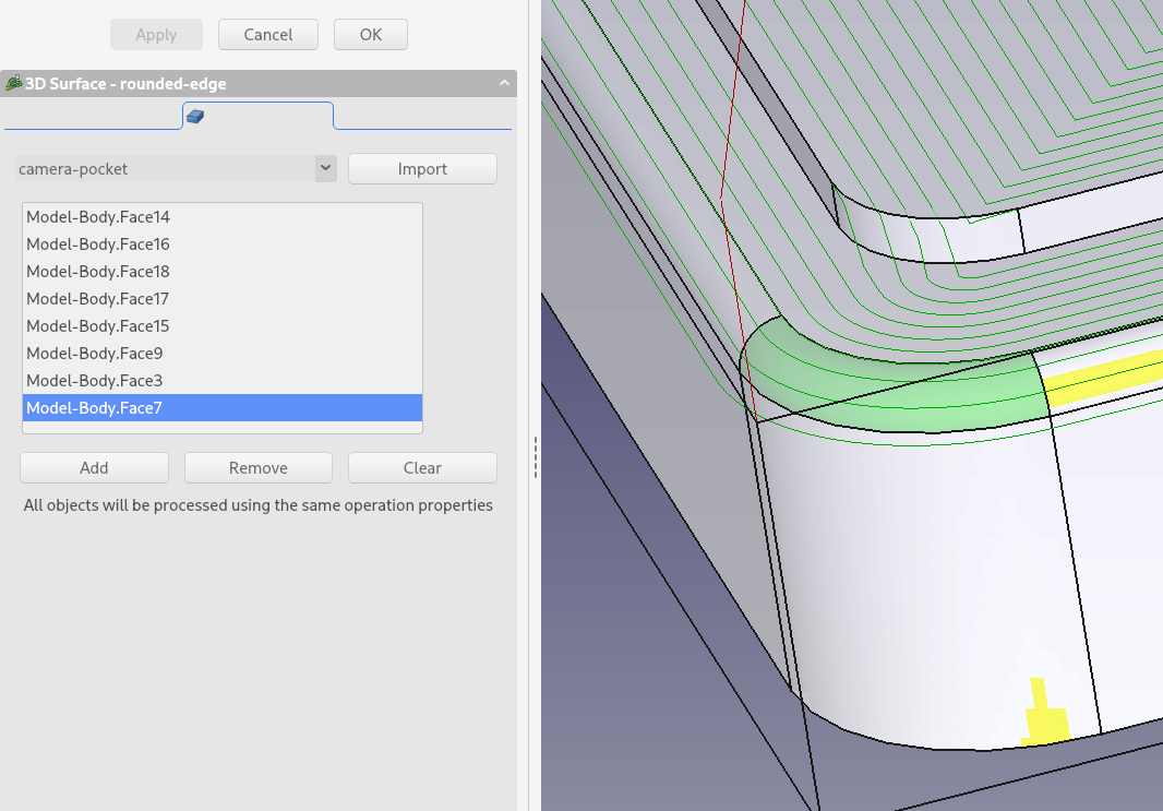

| Description | When selecting all outside edges of a shape for a single 3D surfacing operation, the entire model gets 3D surfaced; Expectation is just the selected edges are 3D surfaced. Associated thread: https://forum.freecadweb.org/viewtopic.php?f=15&t=56981 | ||||
| Steps To Reproduce | Add all outside edges of a shape to by applied within a single 3D surface operation and apply. | ||||
| Additional Information | The attached images demonstrate that the inclusion of face 7 to the 3d surface operation to complete the outside perimeter causes the entire model to be 3D surfaced. Further commentary on the images may be found in the original thread https://forum.freecadweb.org/viewtopic.php?f=15&t=56981 | ||||
