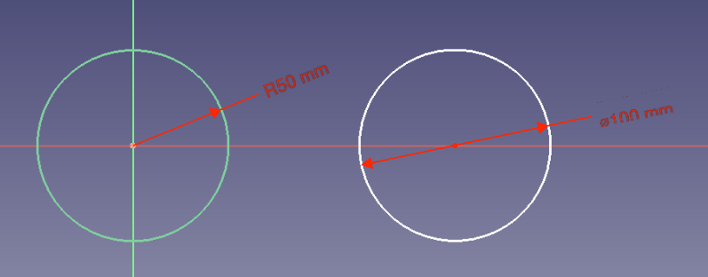

| Summary | 0004779: Sketcher ... Diameter of a circle, part of text missing, but OK on the radius of the same circle | ||||
| Description | I am using Sketcher to set the size of a the Diameter of a circle but the bottom part of text is missing, but OK on the radius of the same circle ? This has the same bug in these versions ... OS: Ubuntu 21.04 (KDE/plasma) Word size of FreeCAD: 64-bit Version: 0.20.26202 (Git) AppImage Build type: Release Branch: master Hash: ca6d49d080dea0abc23d954743eca7c46f33469b Python version: 3.9.7 Qt version: 5.12.9 Coin version: 4.0.0 OCC version: 7.5.3 Locale: English/United Kingdom (en_GB) AND ... OS: Ubuntu 21.04 (KDE/plasma) Word size of OS: 64-bit Word size of FreeCAD: 64-bit Version: 0.19.24291 (Git) AppImage Build type: Release Branch: (HEAD detached at 0.19.2) Hash: 7b5e18a0759de778b74d3a5c17eba9cb815035ac Python version: 3.8.8 Qt version: 5.12.9 Coin version: 4.0.0 OCC version: 7.4.0 Locale: English/United Kingdom (en_GB) BUT works correctly in Snap version ... OS: Ubuntu Core 20 (KDE/plasma) Word size of OS: 64-bit Word size of FreeCAD: 64-bit Version: 0.19.24276 (Git) Build type: Unknown Branch: releases/FreeCAD-0-19 Hash: a88db11e0a908f6e38f92bfc5187b13ebe470438 Python version: 3.8.5 Qt version: 5.12.8 Coin version: 4.0.0 OCC version: 7.5.0 Locale: English/United States (en_US) | ||||
| Steps To Reproduce | Make circle in sketcher, use the diameter tool to dimension. | ||||
| Tags | appimage | ||||
| FreeCAD Information | OS: Ubuntu 21.04 (KDE/plasma) Word size of FreeCAD: 64-bit Version: 0.20.26202 (Git) AppImage Build type: Release Branch: master Hash: ca6d49d080dea0abc23d954743eca7c46f33469b Python version: 3.9.7 Qt version: 5.12.9 Coin version: 4.0.0 OCC version: 7.5.3 Locale: English/United Kingdom (en_GB) | ||||
@GazBaz : please always submit your issue first by opening a new topic in our forum before opening a ticket according our reporting guidelines Will ping @abdullah about this as he is currently refactoring the drawSketch code. I can confirm the issue. |
Discussed here : https://forum.freecadweb.org/viewtopic.php?f=10&t=63041&start=10#p547303 I can reproduce. Pull request : https://github.com/FreeCAD/FreeCAD/pull/5185 |
PR merged |
