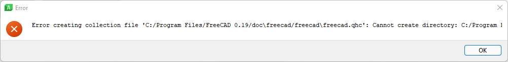

Product Version0.19
Summary0004818: Unable to open the help documents
DescriptionI am unable to open the Help menu from the menu bar. It also seems that it is mixing forward and back slashes could also cause issues.
Steps To ReproduceUsing the Default installation directory for Freecad for Windows "C:\Program Files\FreeCAD 0.19"

Hey the problem seems that FreeCAD needs to run as admin once so that it can create the files and dirs, related to your error message.
Solution: Run FreeCAD with Admin privileges once.
Windows:
  • Open Search
  • Type FreeCAD
  • Click on Run as administrator below FreeCAD name
  • Once loaded, close it, hopefully everything should now onward.
Linux:
  • Open Terminal
  • Type sudo freecad
I tested this on Arch Linux and Windows 11.
