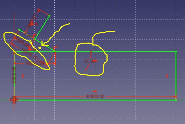

Summary0000753: angle constraint auto places the constraints visuals including its value in the wrong place
Descriptionangle constraint auto places the constraints visuals including its value in the wrong place
For example in the files attached there is an angle constraint between to lines but the constraint and its value are shown 180 degrees from their expected appropriate position in the sketch.
Steps To Reproducesee FreeCAD file and screen shot attached

the issue in this ticket is circled in the screen shot in yellow to the right. The other circled constraint relate to constraint visual being auto/default placed on top of each other and relates to ticket number 0000752
mrlukeparry
2012-06-16 09:38
developer   ~0002211
recognised. I assume this doesn't happen with the older Constraint Visuals (outside my branch) so I hopefully I can look back at the previous code and get it fixed.

issue 0000753: angle constraint auto places the constraints visuals including its value in the wrong place Affected Issues
0000753
mod - src/Mod/Sketcher/Gui/CommandConstraints.cpp Diff File
