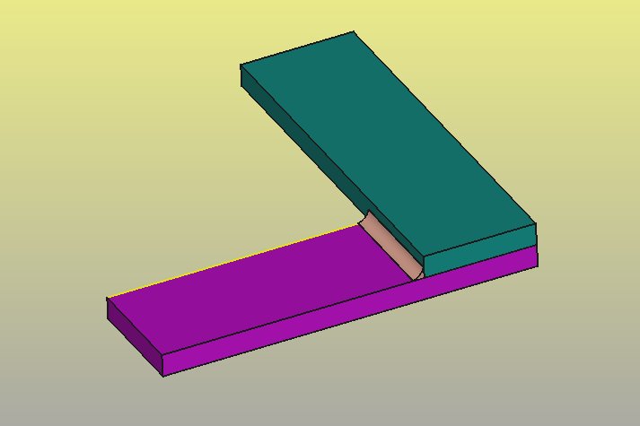

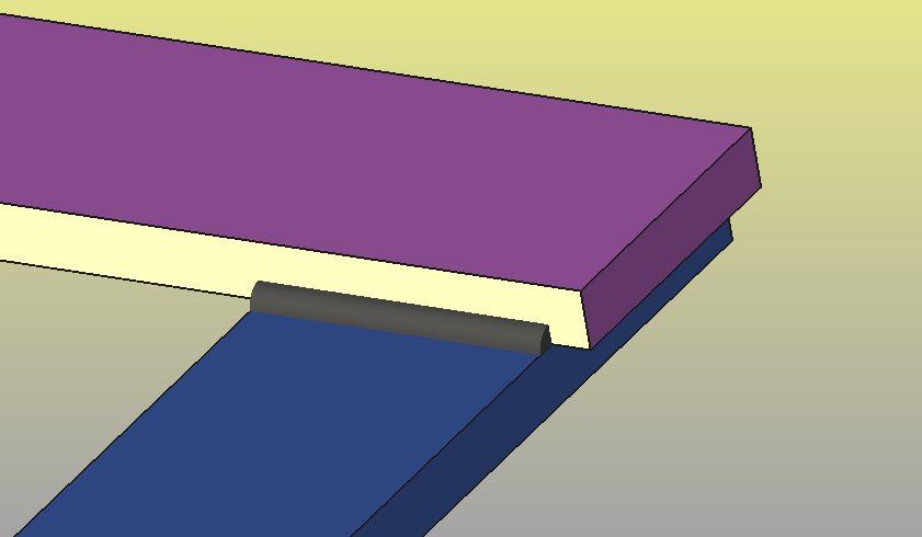

Summary0001240: Welding WB (which also includes Technical drawing symbols)
DescriptionThink of iron welding, hot glue, silicon sealer...
Because the welding material is an object of its own, and its volume is not insignificant.
Like "fillet" or "chamfer", but where two elements meet.
And by elements I mean, a point, a line, a surface.
We would select two of the above and we would apply "weld".
We would determine the thickness of the weld material,
and the allowed, maximum, possible gap between them.
Because these two elements might cross each other,
or there might be a little space between them (for example 1mm).
The weld would be applied on the "free" areas.
It must be graphically clear that this is a weld.
Useful for both the design and the construction of a project.

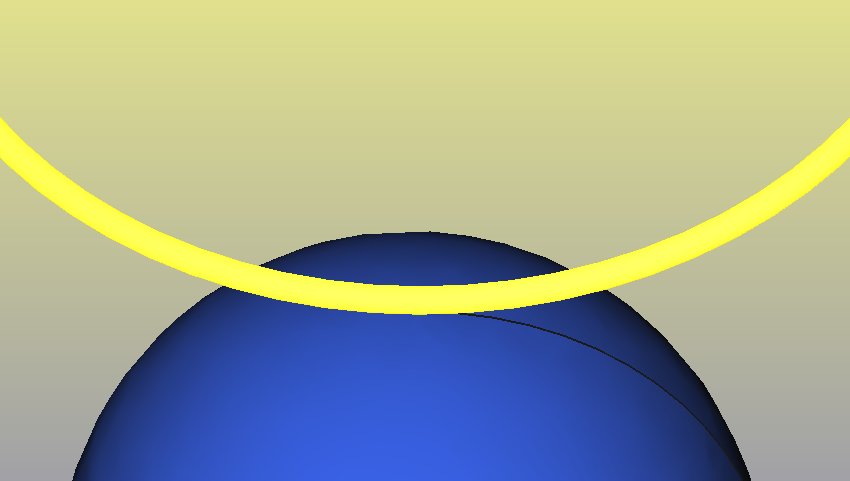

Additional InformationI 've made two pictures, showing how weld might look like.
And there is a third picture.
I can't imagine how Freecad would calculate the welding, for this case.
