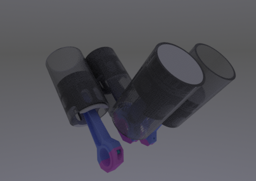

@howetuft is this possible in the Render WB ? (Since Raytracing WB has been superceded by the Render WB) |
Yes, it is possible if the part is an Assembly, made of subparts (see picture below). In a more specific way, it is also possible for parts supporting multimaterials (currently restrained to Arch Windows) |

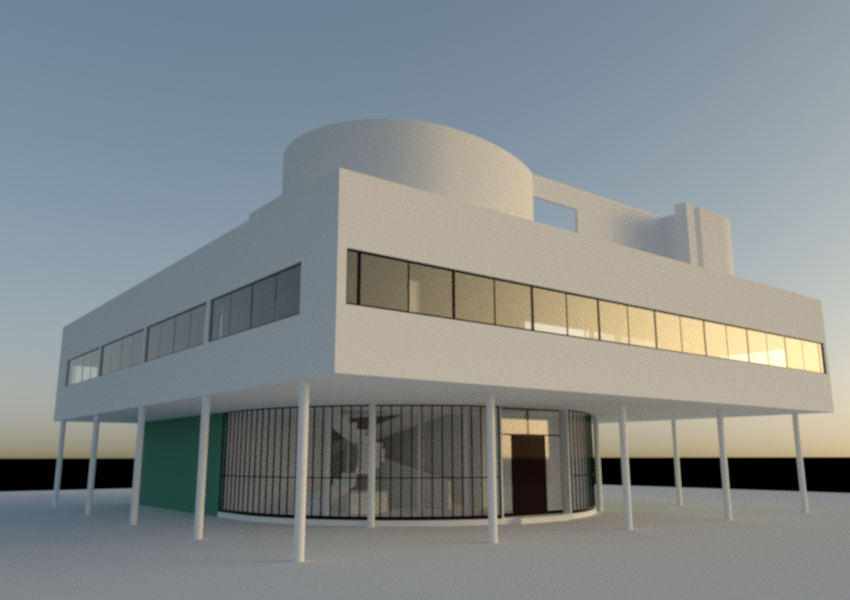

Multimaterial feature is currently implemented for Arch Windows, Walls and Panels in FreeCAD (Arch Multimaterial), but I've implemented support only for Arch Windows at the time. You can see an example in the above picture: the windows and the door are made of a brown matte material for the frame and a glass material for the glass panel, all of them embedded in a multimaterial. Maybe one day I'll extend to Arch Walls and Panels; but it is not very useful for rendering, as the core material is hidden most of the time... Nota (credits): example below is Villa Savoye model, by paullee, rendered with Appleseed. |
