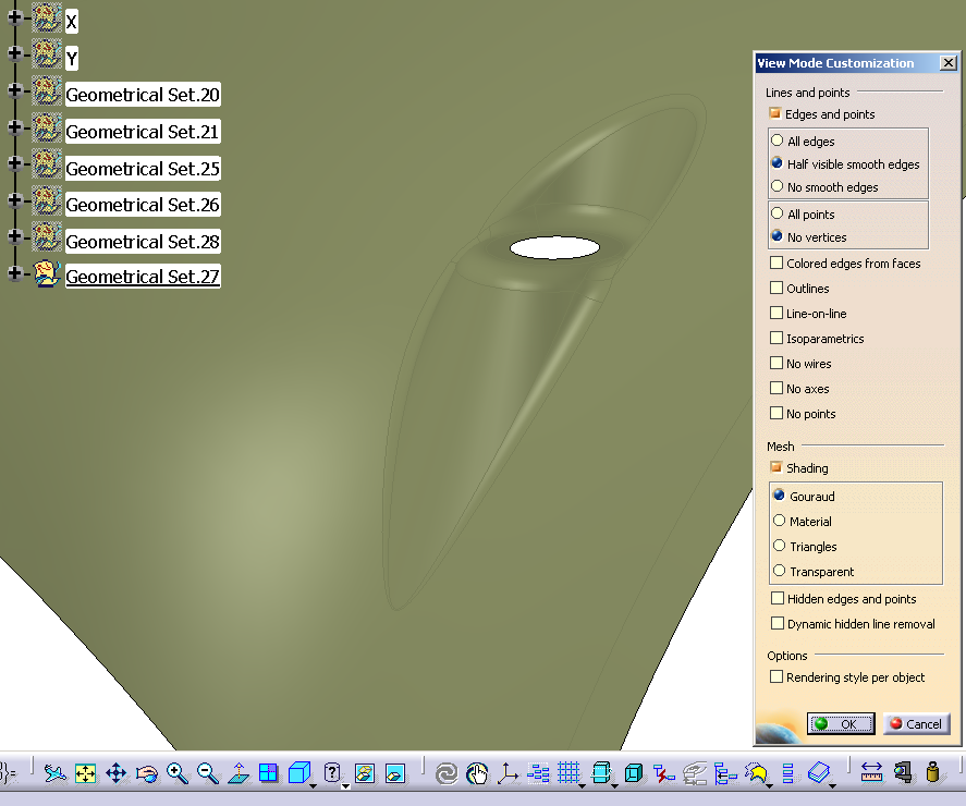

| Description | Hi, I would like to see tangential lines width half the size of boarder lines and in a bleaker color. This makes it easier on the eyes and you can emediatly see if two surfaces are tangential or not - speeds up work. Regards Pauvres_honteux | ||||

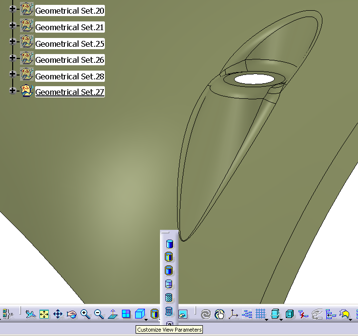

|  | Sorry for not being clear enough. With tangential lines I mean the lines that are visible on a surface where, for example, a flat surface pass over to a curved surface like in a radius between two perpendicular surfaces. When one see that passage you would immediately get a visual confirmation on its state: sharp (boarder line width), tangential (half boarder line width), or curve smooth passage (no line at all). Example: The three different basic passages - http://s3files.core77.com/blog/images/3surface.jpg The black line equals C0 (not tangent and sharp), the "half width bleak colored" light grey line equals C1 (tangent), the gap will eventually be filled by a curvature correct surface and its boarders limit will no be visible, i.e. C2 - http://architosh.com/wp-content/uploads/2013/09/03_evolve_chair_surface_blend.jpg Tangential lines with no difference to boarder lines - http://www.inceptra.com/images/newsletters/newletter6/catia_14.jpg |

|  | Hi guys, pictures were done in Catia. Don't ask me why I went over the top with all the tangent lines and tangent circle and what not. Maybe I had the first picture I made a link to in mind... Anyway, you seem to understand what I originally proposed and that's what counts. In V5 you can also turn off all internal tangent lines. While this makes any non tangent line really stand out it's hard to see how the surfaces really looks like. To summarize it a bit I'd say an really easy option for switching between different viewing behaviour is high on my whish list. |

|  | Shame on thy giving up... Hopefully these pictures are clear enough? To clarify this once and for all: this issue is about the line seen between two surfaces in contact with each other. In CATIA there's an exception: curvature transition between surfaces does not show any line, but it would be beneficial to have another line type for that. @Kunda1, what do you think about cleaning up this thread and remove all misunderstood/irrelevant stuff? I think the links I originally posted can be removed as well. |
