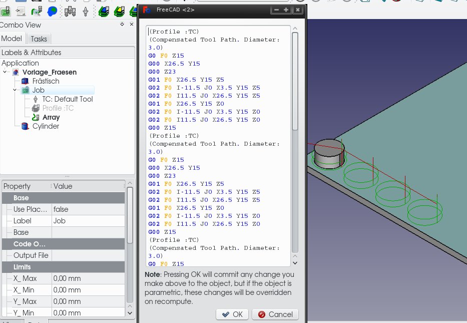

| Description | If i make a array of a path, the exportet gcode contents the first path 2 times, if i make the gcode by exporting job to gcode. It happens also if i make the original path invisible. | ||||
| FreeCAD Information | |||||
|  | The problem is that Array includes the original Path, but doesn't claim it as it's child (and deactivates it). This makes the original Path appear twice, once from itself, and once a copy from Array. There are 2 way of fixing this -) Not include the original path in Array, and just produce output for the copies -) Let Array claim the original Path as a child The workaround would be to set the original Path "Active=false", interestingly this also turns off any output from the Array - and Array does not have an Active property itself. Checking the Copy op from the same category it's output does not include the original Path (and it also doesn't have an Active property). For consistency it might be better to remove the output for the original Path. |

| 2016-11-16 05:59 | mlampert | Note Added: 0007462 | |
| 2016-11-16 06:17 | mlampert | Assigned To | => mlampert |
| 2016-11-16 06:17 | mlampert | Status | new => assigned |
| 2016-11-16 09:35 | wmayer | Changeset attached | => FreeCAD Master master cb16eda2 |
| 2016-11-16 09:35 | wmayer | Status | assigned => closed |
| 2016-11-16 09:35 | wmayer | Resolution | open => fixed |
| 2016-11-16 09:35 | wmayer | Fixed in Version | => 0.17 |
