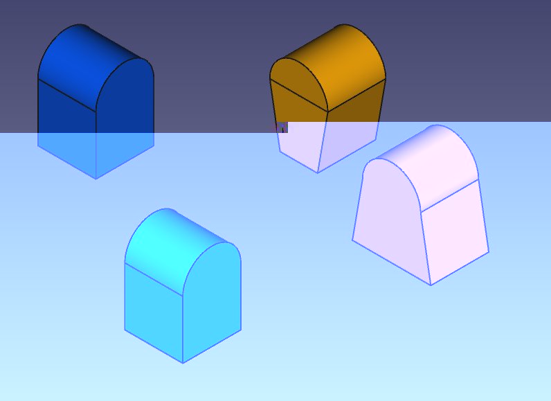

| Description | Despite I have same shapes, I've got some troubles with Draft in V0.17: Draft from a Loft doesn't work. Draft seem to be inverted either its born from a cube or a refine shape. | ||||

|  | @GlouGlou please post full version info and also link to forum thread discussing this issue. Thanks. |
|  | Sorry first tracking ;-) OS: Windows 8.1 Word size of OS: 64-bit Word size of FreeCAD: 64-bit Version: 0.17.12619 (Git) Build type: Release Branch: master Hash: b3631e134be8bfade0534f2dc0ee668ae71a223f Python version: 2.7.8 Qt version: 4.8.7 Coin version: 4.0.0a OCC version: 7.1.0 Locale: French/France (fr_FR) https://forum.freecadweb.org/viewtopic.php?f=3&t=25297 |
|  | Per @bejant For some reason Loft does not create planer faces between the Sketches - and although planar faces is not the Draft problem with curved surfaces, the problem may be in the faces Loft does create. |
