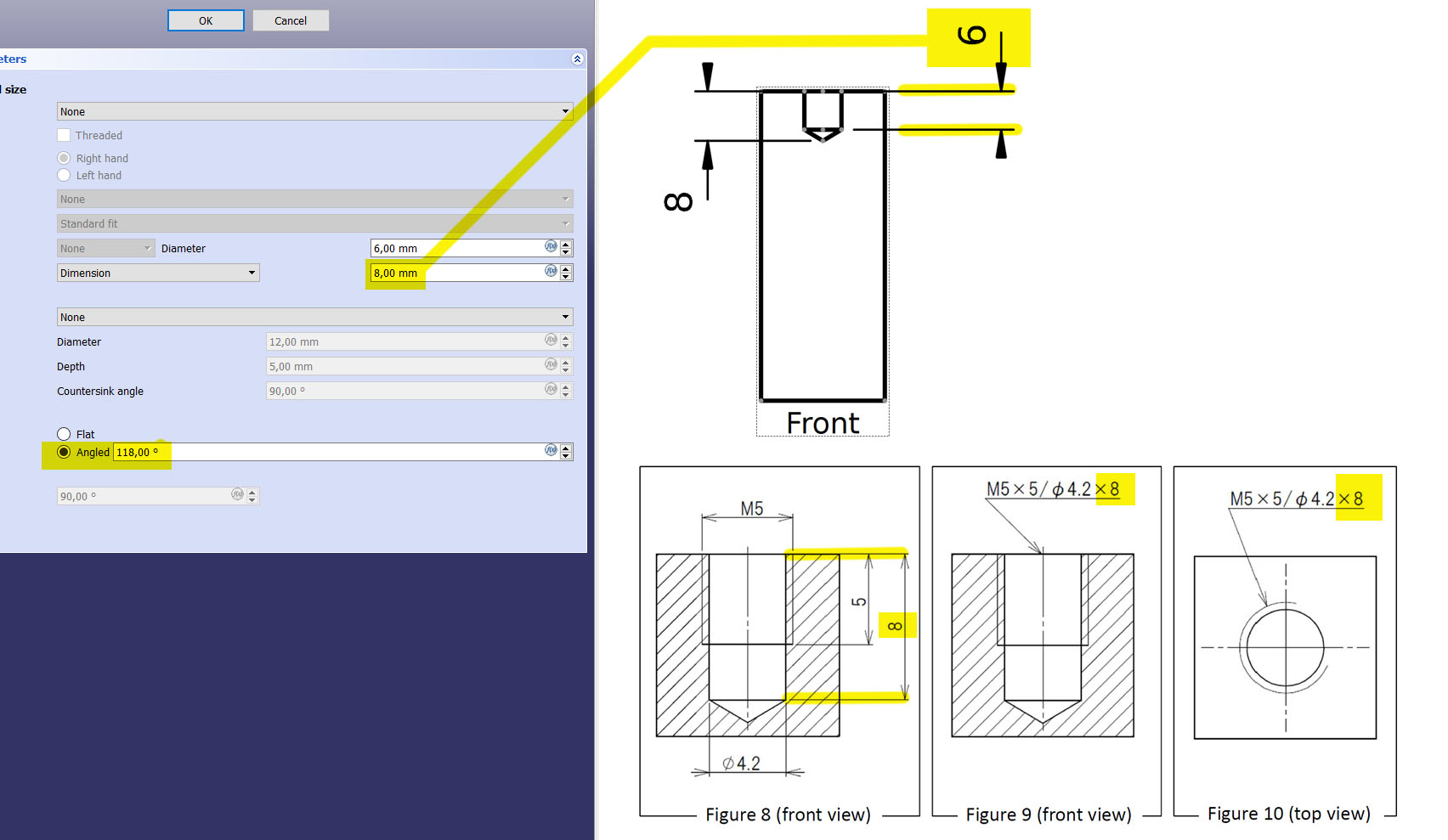

DescriptionIn the PartDesign Hole feature, the Depth Dimension option controls the overall depth of a blind hole. When the Drill point option is set to Angled, the dimension includes the conical end point generated by the Angled drill point option.
There should be an option to set the depth dimension so that it does not include the conical end point, to comply with some standards.
http://euro.branly.free.fr/ISI/Construction/Dessin/filet/filets.htm
http://joho.p.free.fr/EC/COURS%20DOC/FILETAGE/REPRESENTATION/Cotation%20des%20filetages.pdf

manager   ~0012616
Okay, I think I understand the issue now. You actually want the hole depth NOT TO take the conical end into account.
This would be a feature request then, because in commercial software I use, both possibilities are offered (depth with or without the conical drill point).

reporter   ~0012617
hello, the downhole cone should never be included in the hole depth, it is only the consequence of the shape of the drill bit. The depth of a hole should take into account only the part with the correct diameter. see the two links of my first post.
if you want to add a feature, you should be able to choose the thread depth and drilling depth. Drilling and always deeper than the threading so as not to break the tools. the angle of the drilling cone is 120 degrees, the angle of the thread is 90 degrees. I do not have freecad until Tuesday, I promise you to make a correct post as soon as possible.

LAROBERTE
I disagree. At work, plenty of time I really, really needed to define the total depth of a blind hole including the drill tip, so it would not punch through the material or would leave minimal thickness. Doing it your way would require guesswork or calculation.
As I said, Solid Edge (a commercial mid-range CAD package) offers both options. FreeCAD should do the same.
Your other arguments about thread depth and drilling depth are of course to the point. But the Hole feature cannot currently display a modelled thread, and the TechDraw workbench cannot extract hole information nor display it; so implementing this at this time would not really be useful. With 0.18 nearing release I doubt that we will see this implemented before release, which is why I set the target version to 0.19. Unfortunately, there is no longer a developer dedicated to the PartDesign workbench.

reporter   ~0012619
I agree with you, which is why my first post did not mention a request to add a function. I know that Freecad is evolving, but in the current state of things, the most important is the useful depth of the hole, which is the current standard in technical drawing. if you feel that the cone depth is half a diameter, you will have no problem and it is very easy with a 3D software to see if the cone of the bottom of the hole passes through.
Of course, if the drill cone is a problem, nothing prevents you from making a hole with a flat bottom with a suitable tool.

Hello
For years, technicians have been working to develop international standards for technical drawing.
If you want freecad to become one of the software that can also be used by professionals, you have to respect them.
The Hole function of freecad is for the moment only the draft, I am sure, of a practical and complete intuitive function. You can add as many functions as you want, but basic functions and their default values ​​must comply with existing standards.
I am willing to participate on a forum to help develop Freecad, this particular function, but I opened this post only to correct this glaring error which will only cause the development of other functions or options for the materialization of the threads of freecad.
I'm not sure if the translation is understandable, I'm really sorry I do not write English directly.
I leave attached sketches that will be more meaningful than me.

manager   ~0015043
Thanks for the report. We are currently fixing all known hole dialog issues, see this forum thread: https://forum.freecad.org/viewtopic.php?p=453371#p453371
Should your requested option be the default or not?
I checked and asked colleagues, it is indeed the common rule not to take the drill angle into account. Here are some more documents stating the same as the French ones the bug reporter linked:
https://www.technisches-zeichnen.net/technisches-zeichnen/grundkurs-03/gewinde-bemassen.php
https://www.joshuanava.biz/engineering-3/draughting-conventions-associated-with-threads.html
So I will add this option and make it default.
