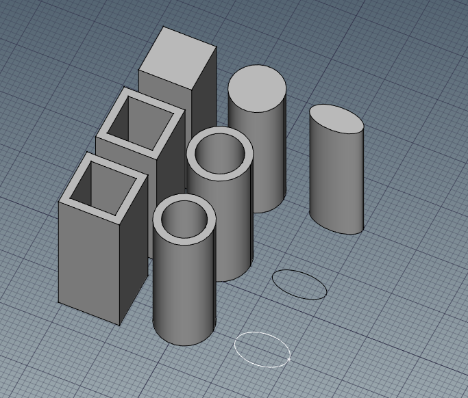

| Description | When I create an arch wall from a sketch with an elliptical, parabolic, or B-spline curve, it doesn't make anything. In the report panel it says: DraftGeomUtils: unable to bind wires Error: Invalid base object Creating a wall from a circle or circular arc works OK. I haven't tested other shapes such as regular polygons, slots, etc. | ||||
| Steps To Reproduce | Create a sketch with an elliptical, parabolic, or B-spline curve (hyperbolic probably does it too). Exit sketcher and go to Arch workbench. Select the sketch and click on the 'Wall' button. | ||||

I dug into the code a bit more. Once I changed the isinstance() in ArchWall.py to also include the other types of curves, and the same change in DraftGeomUtils.offsetWire() The root of the problem is that DraftGeomUtils.offset() doesn't handle any shapes except lines and circles/arcs. Conceptually, we want to create a curve that is a fixed "offset" distance away from the tangent of the curve in question. For a Parabola, Hyperbola, and Ellipse that can be done by scaling a copy of the original shape by the right amount in each direction. I dunno how to do that in FreeCAD. I have no clue what the right solution is for B-spline and Bezier curves. I can imagine how to make a Logo turtle do it but not FreeCAD :-) B-spline and Bezier also have the weird issue of being able to loop back over themselves and cause really funny problems for walls. So far I've found five shapes that aren't supported by DraftGeomUtils.offset(): Parabola, Hyperbola, BSplineCurve, Ellipse, and BezierCurve DraftGeomUtils.geomType() also needs fixing up to handle more types of shapes. |

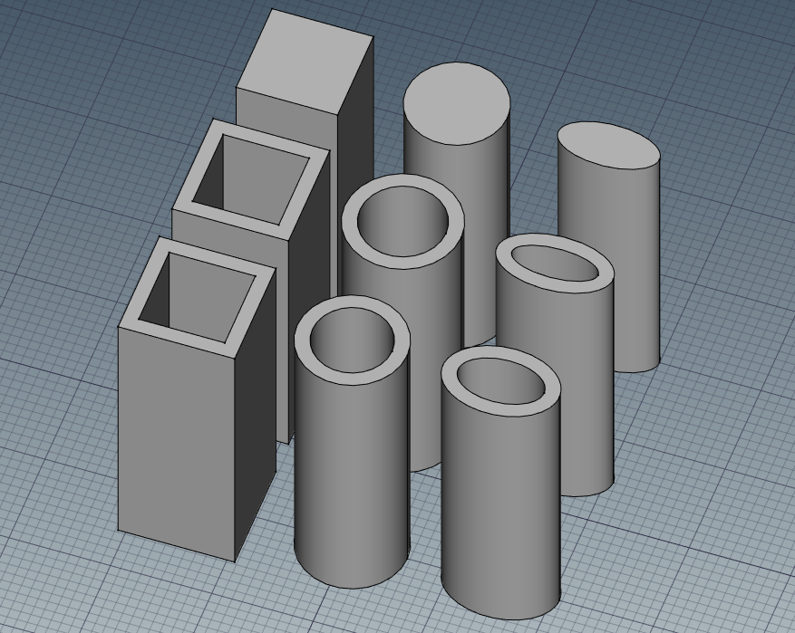

Indeed walls can still not be built on elliptic wires.. Probably because the Draftgeom offset function cannot offset it. I'll have a look at it |
Indeed @yorik has merged the request to support circle. But I remeber the code is not prepared to accept ellipse, parabola, bspline etc. Those complex curve are difficult for me, maybe ellipse. Anybody to attempt ? Maybe for those has more frequent usecase For modelling Corbu's Carpenter Center, I just use a series of arc to trace through the shape. |
Fixed with https://github.com/FreeCAD/FreeCAD/commit/87eae7c58cdfda2ca05b0edaa770e848b7f0c8ed |
