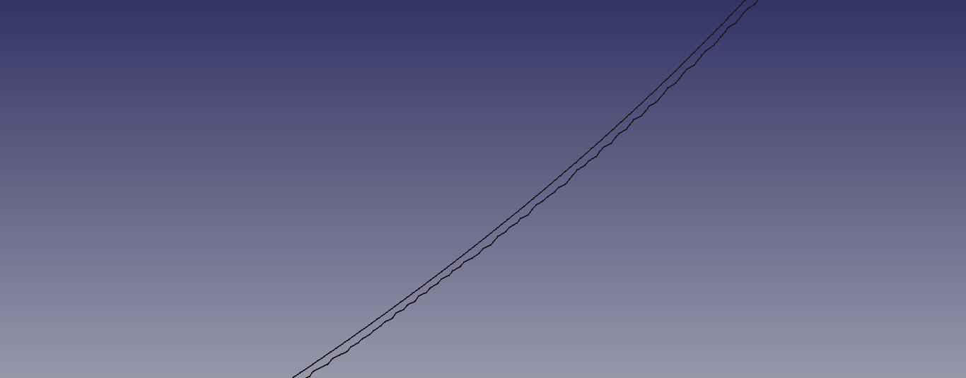

| Description | When I created an object(wire,point,mesh etc.) at large coordinate values(eight or nine orders of magnitude), object look vawy. When zoom in or zoom out objects change their positions. I think OCC uses 32bit float variables and it dont work properly at large coordinates. FreeCAD need a general solution that works for every workbench at large coordinates. In the script below, I create a list with several points with the larger values, then re-reference those points w.r.t the start to 'normalize' them and get the values into a smaller range. The difference is obvious when it gets rendered. | ||||

The problem is that the internal view and model matrices of Coin3d causes quite big round-off errors when multiplying with huge coordinate values. |

I think core implementation of this Coin class can solve problem https://coin3d.github.io/Coin/html/classSoGeoOrigin.html#details |

We are start to working on something. https://forum.freecadweb.org/viewtopic.php?f=8&t=22277&start=980#p395784 Also I created a guide to use SoGeo classes. https://forum.freecadweb.org/viewtopic.php?f=3&t=36362 I hope the other FreeCAD workbenches will be start to integrate SoGeo objects. |
