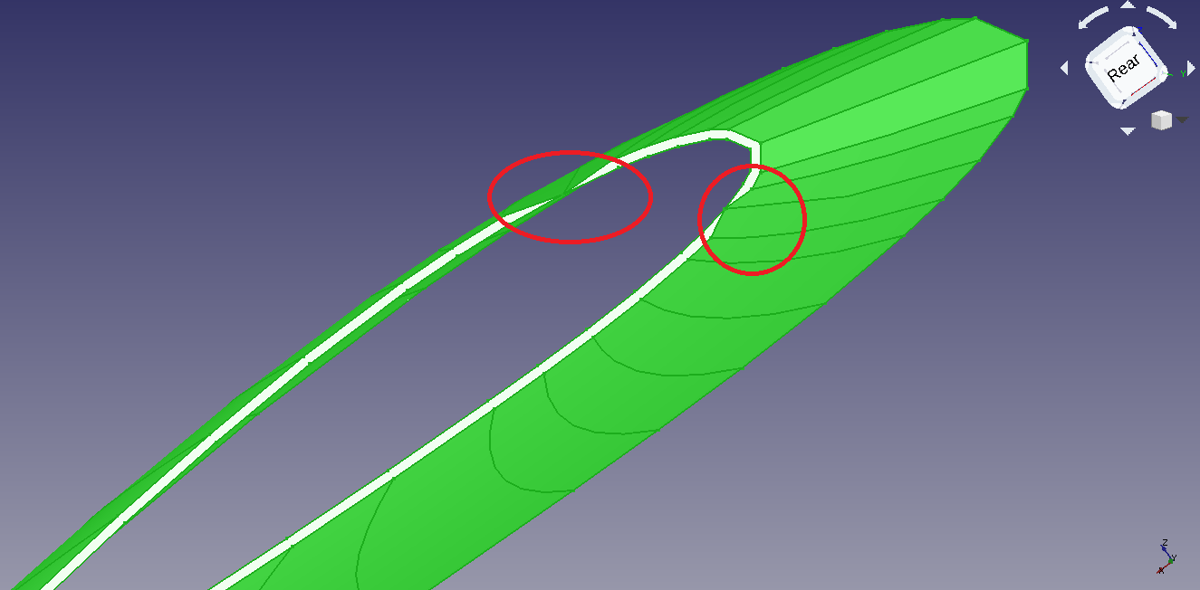

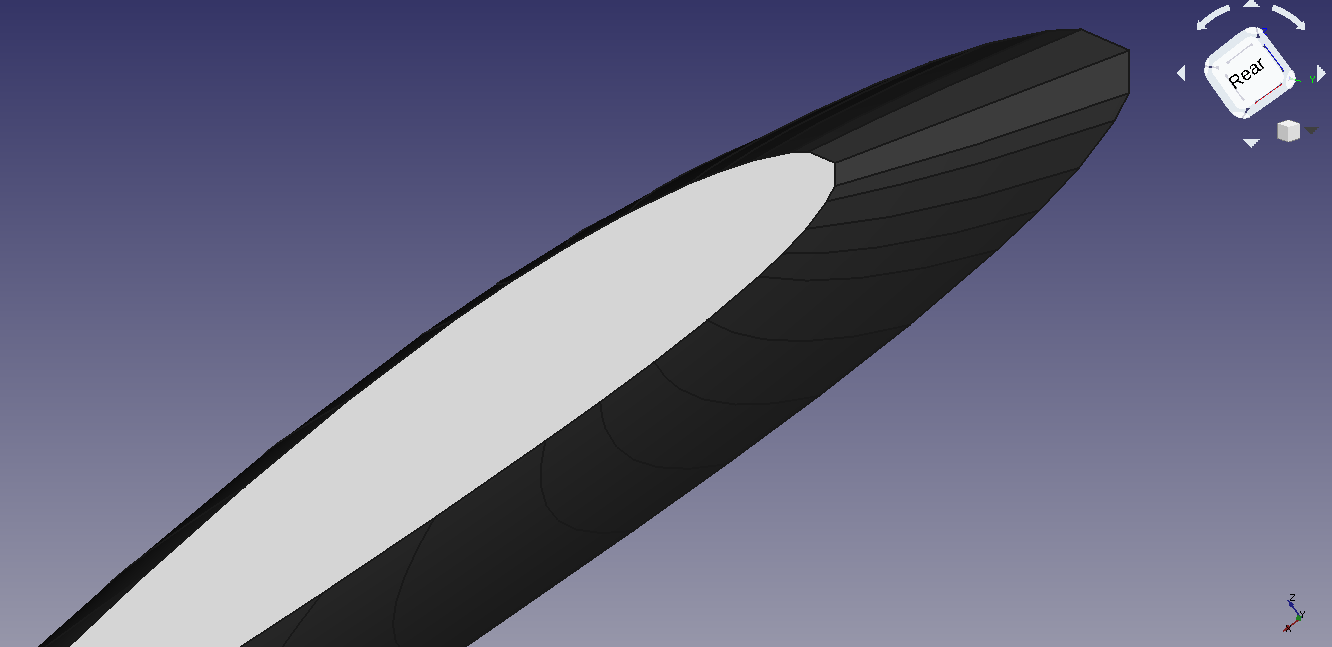

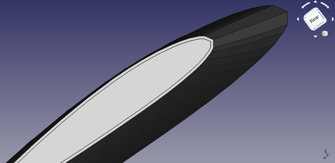

DescriptionThe cut operation of two lofts make unexpected result. The resulting object doesn't keeps outside shape of original sub-components.
Lofts are created from multiple sketches.
It looks that some points (2 in my case) of the original outside object are replaced by points from inside (subtracted) space.
Steps To Reproduce1. Start the FreeCAD
2. Open attached file (Jak9-WingTip.fcstd)
3. Select the Part workbench
4. Make a Cut of two shapes: (WingEndOuter - WingEndInner)
5. Check resulting object on the thinnest (higher Y coord) side for distortion

@david254 : sorry but this is just EBKAC. ;) In the properties of the 'Cut' (Property editor -> View tab), just adjust deflection and deviation to something more appropriate to the scale you're working on (eg. Angular deflection = 1 / Deviation = 0.05). Then recompute & everything is fine.

@openBrain it not work.

Recompute fixes the issue.
