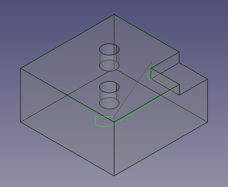

| Summary | 0004280: LeadinLeadout DressUp Causes Tool Crash on Deburr Ops | ||||
| Description | Forum Post: https://forum.freecadweb.org/viewtopic.php?f=15&t=43896 | ||||
| Steps To Reproduce | Create a deburr operation, Add a leadinleadout dressup. observe that part of the deburr path is likely missing and the path intersects the model. | ||||
| FreeCAD Information | OS: Debian GNU/Linux 10 (buster) (GNOME/gnome) Word size of OS: 64-bit Word size of FreeCAD: 64-bit Version: 0.19.19803 (Git) Build type: Unknown Branch: master Hash: 1bd4a173ef1e8a68e074ef9a7e6003430eac5e2d Python version: 3.7.3 Qt version: 5.11.3 Coin version: 4.0.0a OCC version: 7.3.0 Locale: English/UnitedKingdom (en_GB) | ||||
|  | @dubstar_04 please add the FC info in the field dedicated to it called 'FreeCAD Information' for posterity reviewers/devs etc... |
|  | The original issue seems to be resolved however on internal edges the path still intersects the part. This can be worked around by changing the entry point to an outside edge. Due to the workaround the priority could now be reduced to low but the issue could be revisited. |
|  | The dressup isn't aware of the part shape and is just applied at the current place. To avoid problems like this, you can choose the entry point. |
