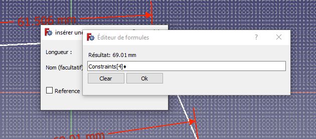

| Summary | 0004325: Strange character after bracket, appear in expression input field for a constraint in sketcher | ||||
| Description | When I type in expression containing bracket in the expression editor a strange character appear at the end of the entered text. | ||||
| Steps To Reproduce | 1)	Create a new sketch 2) Create 2 new line. 3) Create a dimension constraint on the first line. 4) Create a dimension constraint on the second line and then enter the “=” sign to edit expression. 5) Type in the expression “Constraints[0]” Result: just after you type in the last character (that is “]”) the strange character appear in the expression editor | ||||
