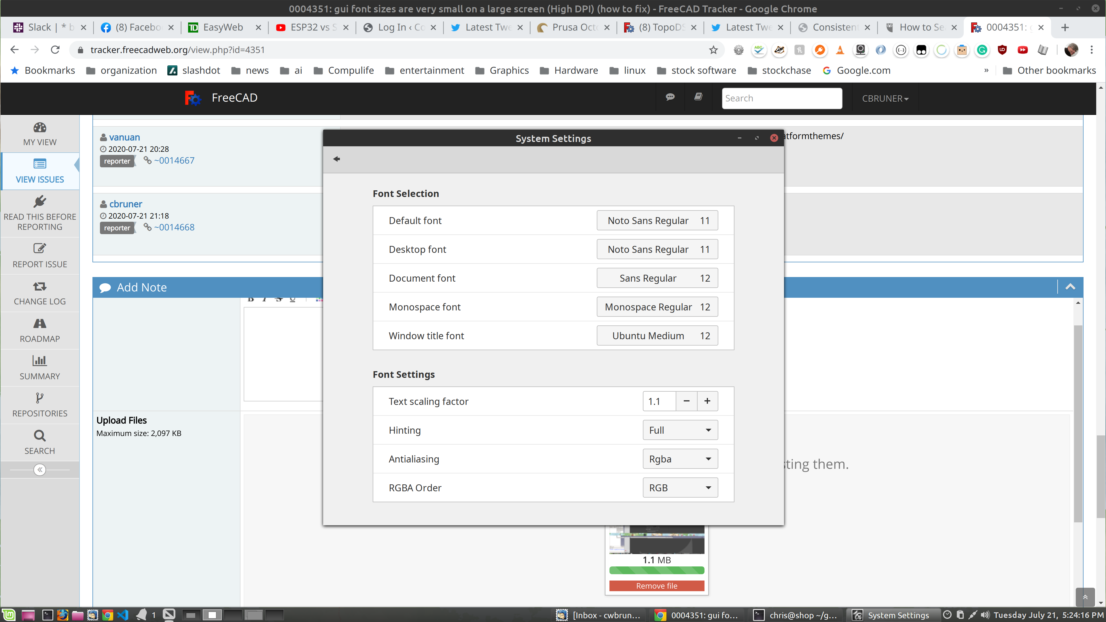

reporter   ~0014668
After installing it, and relogging in, I'm afraid I don't see a difference.
Even compared to openoffice and gimp, freecad fonts are tiny.
ls /usr/lib/x86_64-linux-gnu/qt5/plugins/platformthemes/
KDEPlasmaPlatformTheme.so libqgtk3.so

BTW, Cinnamon uses Gtk3 and D-Bus, right?
cbruner
2020-07-22 21:21
reporter   ~0014681
QT_QPA_PLATFORMTHEME=gtk3 QT_DEBUG_PLUGINS=1 ./bin/FreeCAD
vs
QT_QPA_PLATFORMTHEME=kde QT_DEBUG_PLUGINS=1 ./bin/FreeCAD
kde was a little lighter in colour but otherwise no change in fonts.
-style breeze made no difference to either.
I believe you are correct regarding gtk3 and d-bus
cbruner
2020-08-24 15:33
reporter   ~0014707
A note about this topic. I recently upgraded to Linux Mint 20, and this issue has largely gone away. The only problem as this point is the fonts are slightly larger than the text box. For example, adding a constraint, change the diameter of a circle 18.0 will only show the top 2/3ds of the 18.
vanuan
2020-08-26 07:32
reporter   ~0014713
Any indication what's changed? Qt version?
Has the debug output changed wrt plugins used ( QT_DEBUG_PLUGINS=1 ) ?
Maybe it's just that system font better matches the Qt one?
cbruner
2020-08-26 13:59
reporter   ~0014720
It looks like the qt installed it 5.12.8
No difference in the debug output.
This was a fresh install (keeping my home directories), whereas my old one was updated over the last 5 years, so there was a lot of kruft on it.
Kunda1
2020-10-08 13:45
administrator   ~0014796
Any updates on this issue? What is left to do?
cbruner
2020-10-08 14:45
reporter   ~0014802
as far as I am concerned it can be closed. (It went away when I upgraded my system).
yorik
2022-03-03 13:55
administrator   ~0016899
This ticket has been migrated to GitHub as issue 6066.
