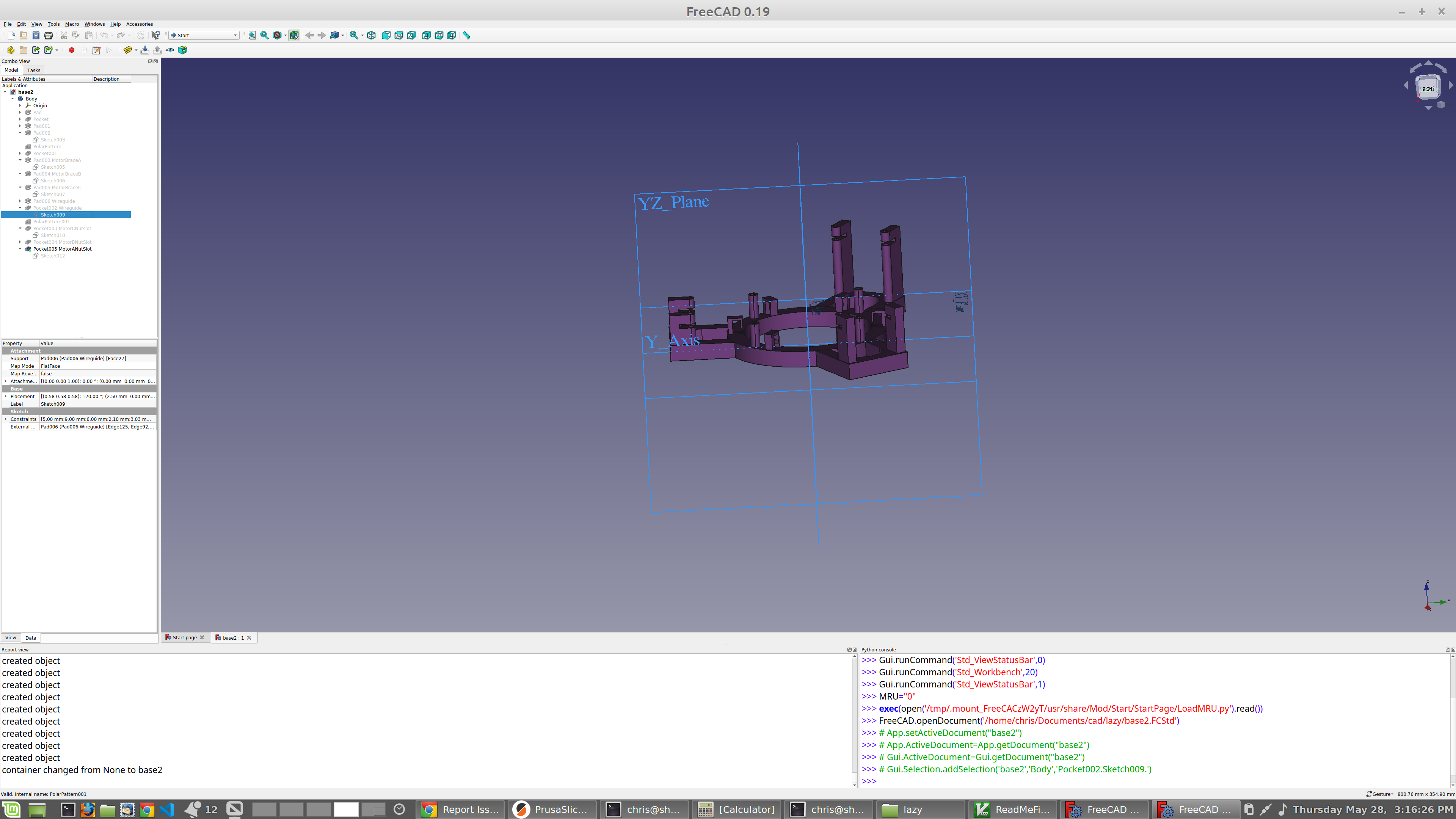

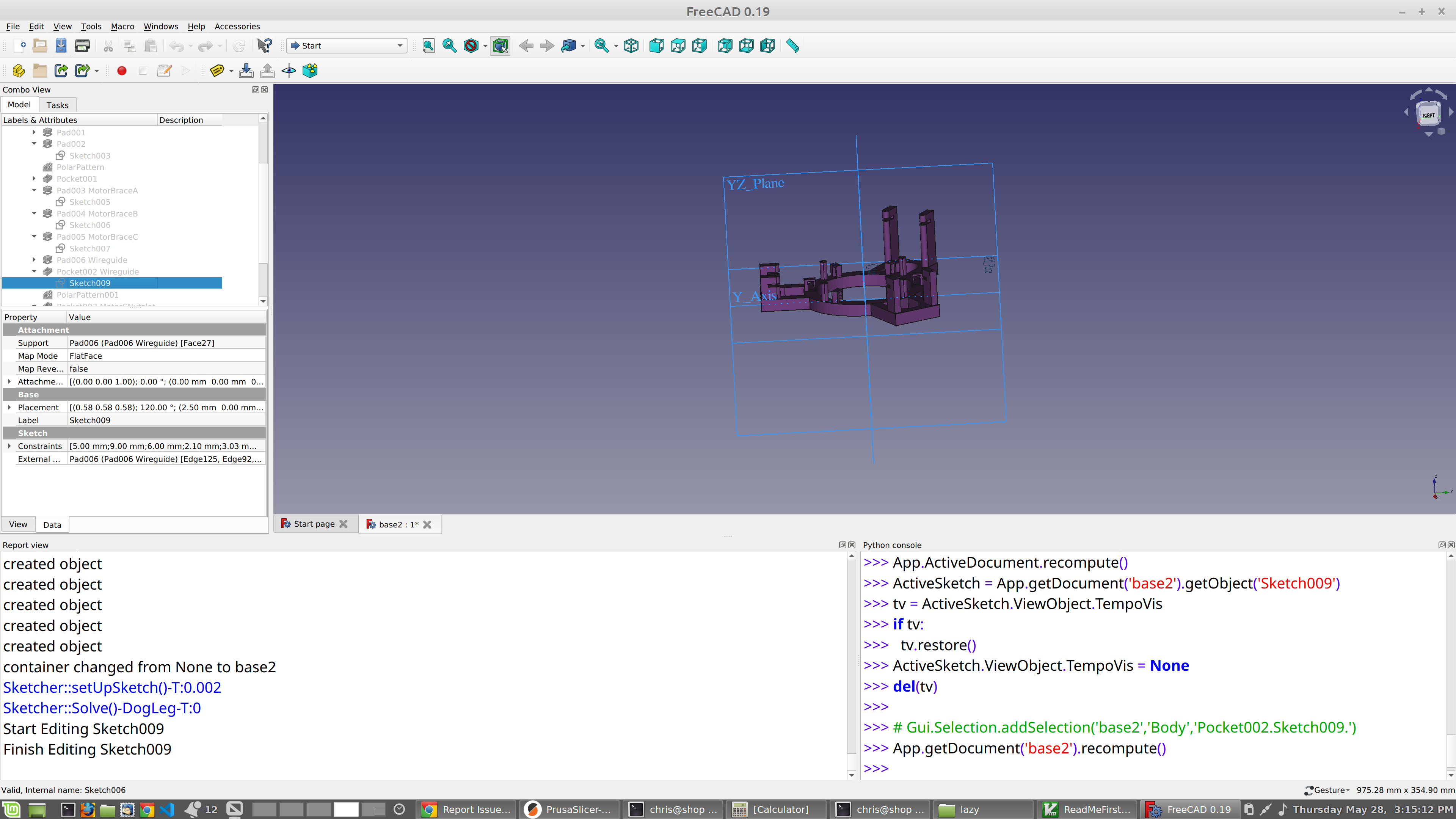

| Summary | 0004351: gui font sizes are very small on a large screen (High DPI) (how to fix) | ||||
| Description | My fix as shown in forum topic https://forum.freecadweb.org/viewtopic.php?f=3&t=41656&p=392509#p392509 is to set environment variables before starting freecad. exec=/usr/bin/env QT_AUTO_SCREEN_SCALE_FACTOR=0 QT_SCALE_FACTOR=1.7 ~/bin/freecad_ QT seems to be borked on highdpi monitors. According to QT documentation, these environment variables can be set inside program. My suggestion is to add to /edit/preferences/general/display a checkbox for QT_AUTO_SCREEN_+SCALL_FACTOR and if not checked then a text field for QT_SCALE_FACTOR. | ||||
| Steps To Reproduce | use any high dpi monitor or large screen (in my case a 4k tv). I've attached two screen shots to illustrate the problem and solution. Current is without env variables set and hidpi is with env set. | ||||
| Tags | GUI, HiDPI | ||||
| FreeCAD Information | OS: Linux Mint 19.3 (X-Cinnamon/cinnamon) Word size of OS: 64-bit Word size of FreeCAD: 64-bit Version: 0.19.21280 (Git) AppImage Build type: Release Branch: master Hash: 6f3160db3e88733536c7eaf97ad7d6ebd21baccd Python version: 3.8.2 Qt version: 5.12.5 Coin version: 4.0.0 OCC version: 7.4.0 Locale: English/Canada (en_CA) | ||||
|  | I see you're using Cinnamon. Have you enabled HiDPI mode in display settings? If yes, what Zoom level did you choose? For example, GNOME supports 100%-400% scaling |
|  | Also, post your output |
|  | 3840x2160 dpi, Double (Hi-DPI) xrdb -query customization: -color Xft.dpi: 211.19921875 Xft.antialias: 1 Xft.hinting: 1 Xft.hintstyle: hintfull Xft.rgba: rgb |
|  | Ok, so it's not smaller than mine. It's just that the difference between window title font size and the Qt calculated font size is larger than mine. This means Cinnamon has larger theme fonts than GNOME's. But anyway, I see it now. Qt's menubar size should match the system's. So it doesn't inherit the theme of the operating system. Googling around I found this: https://github.com/AppImage/pkg2appimage/issues/88 So I doubt it's related to HiDPI. It's rather an issue with AppImages not inheriting the System's theme |
