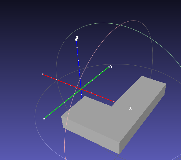

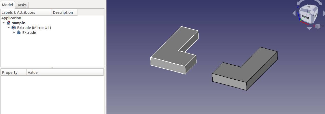

| Description | I am new to Freecad Community, so if I am wrong, please tell me. This issue is very near to this discussion. Problem to export to .obj If you mirror a part A into part B and export the parts(A and B), the original part A do not exported to collada mesh file. This is because the original part A has a parent part, which is the part B. The bug is located here: FreeCAD/src/Mod/Arch/ArchCommands.py: pruneIncluded Since the part which has parent part is judged as not a top level, the part is not exported. Thank you. | ||||
| Steps To Reproduce | Export test.FCStd(attached) to test.dae(attached) in Collada format. | ||||

|  | @rkoyama1623 : please address your issue following our reporting guidelines by opening first a topic in our forum. Thx As your ticket seems OK so far, I'll let it open as is, but it can get more attention if you open a topic though. |
|  | Sorry for that, and I cheked the guidline again. Thank you for merging my PR #3570. Now you can close this issue. (Can I close by myself?) |
|  | Fixed by commit 5d6b86d84535 c:FreeCAD:5d6b86d8: Closing Edit: Modified link to c:FreeCAD:hash: to reference commit Edit2: reverted |
