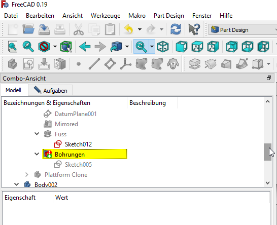

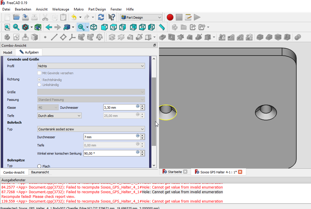

| Summary | 0004371: Changing Hole profile from ISO to nothing is not possible: "Hole: Cannot get value from invalid enumeration" | ||||
| Description | Changing a hole from profile Iso to Nothing runs into the error message: "Hole: Cannot get value from invalid enumeration". It is not possible to confirm the ch 204.555 <App> Document.cpp(3732): Failed to recompute Soxos_GPS_Halter_4_1#Hole: Cannot get value from invalid enumeration Thread size out of range Unhandled Base::Exception caught in GUIApplication::notify. The error message is: Thread size out of range <Exception> Thread size out of range | ||||
| Steps To Reproduce | Try to change a hole with profile Iso back to nothing (example attached). Try to change feature "Bohrungen" back to profile nothing. | ||||
| Additional Information | Forum: https://forum.freecadweb.org/viewtopic.php?f=13&t=47584 | ||||
| FreeCAD Information | OS: Windows 10 (10.0) Word size of OS: 64-bit Word size of FreeCAD: 64-bit Version: 0.19.21514 (Git) Build type: Release Branch: master Hash: 89ddab33f692a9bd739171689f9ab0eb58d64b35 Python version: 3.8.2 Qt version: 5.12.5 Coin version: 4.0.0 OCC version: 7.4.0 Locale: German/Germany (de_DE) | ||||
This fails only if the change is made to an existing hole. |
Fix committed to master branch. |
Some additional changes: https://github.com/FreeCAD/FreeCAD/commit/c0b2188ada1d76b834ad1acf0c0df0392ae7eab0 https://github.com/FreeCAD/FreeCAD/commit/99dd4460c56f4697241bef1d4a4645043c17171c https://github.com/FreeCAD/FreeCAD/commit/6e6f2c8a0a1be3a3a2449ea3b7b6ee4465bd5cce https://github.com/FreeCAD/FreeCAD/commit/a29d834bd31fcf5dedfceb159c4d36c18194197f https://github.com/FreeCAD/FreeCAD/commit/ec46265bc36643265ddd3cee5c9379caa016e012 |
FreeCAD: master fe3f1b51 2020-09-23 09:11:27 Details Diff |
PartDesign: [skip ci] fixes 0004371: Changing Hole profile from ISO to nothing is not possible: "Hole: Cannot get value from invalid enumeration" |
