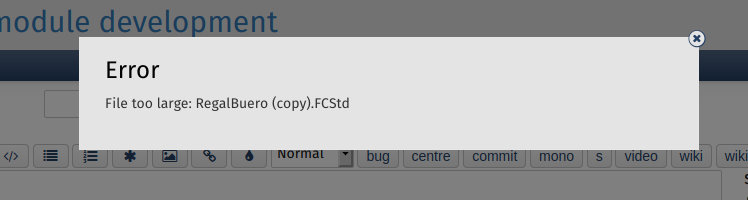

Tried to create a forum thread. But here an error comes when trying to add the file. (see screenshot) But without file, it does not make sense to talk about (Description: On Increasing a pocket size, computer crashes??? ). Is there a possibility to send you the model? |
