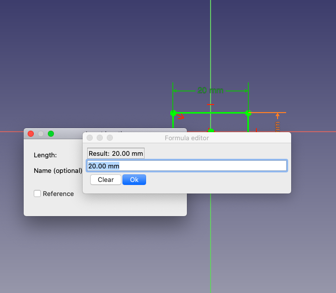

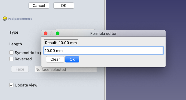

| Summary | 0004384: Formula editor not active window when invoked | ||||
| Description | Clicking formula editor button or entering = sign in constraint dialogue brings formula editor to front but window is inactive requiring user to click or highlight existing text before new text can be entered. Full details and screen grabs available in forum post: https://forum.freecadweb.org/viewtopic.php?f=3&t=48003#p411156 | ||||
| Steps To Reproduce | 1. Open Part Design WB 3. Draw sketch 4. Apply constraint to any sketch element 5. Click formula editor or enter = sign in constraint dialogue box 6. Resulting formula editor window is now top window but not active although any previously entered data is highlighted. 7. Text entry requires clicking in window or selecting pre-existing text to activate or over-write. 7. Text typed without clicking in formula editor will be entered in constraint box | ||||
| Tags | 0.19, GUI, input, macOS, Part Design, sketcher | ||||
| FreeCAD Information | OS: macOS 10.15 Word size of OS: 64-bit Word size of FreeCAD: 64-bit Version: 0.19.21718 (Git) Build type: Release Branch: master Hash: 002e25b5617f2c79f65968f1f82f7267899965c3 Python version: 3.8.2 Qt version: 5.12.5 Coin version: 4.0.0 OCC version: 7.4.0 Locale: C/Default (C) | ||||
