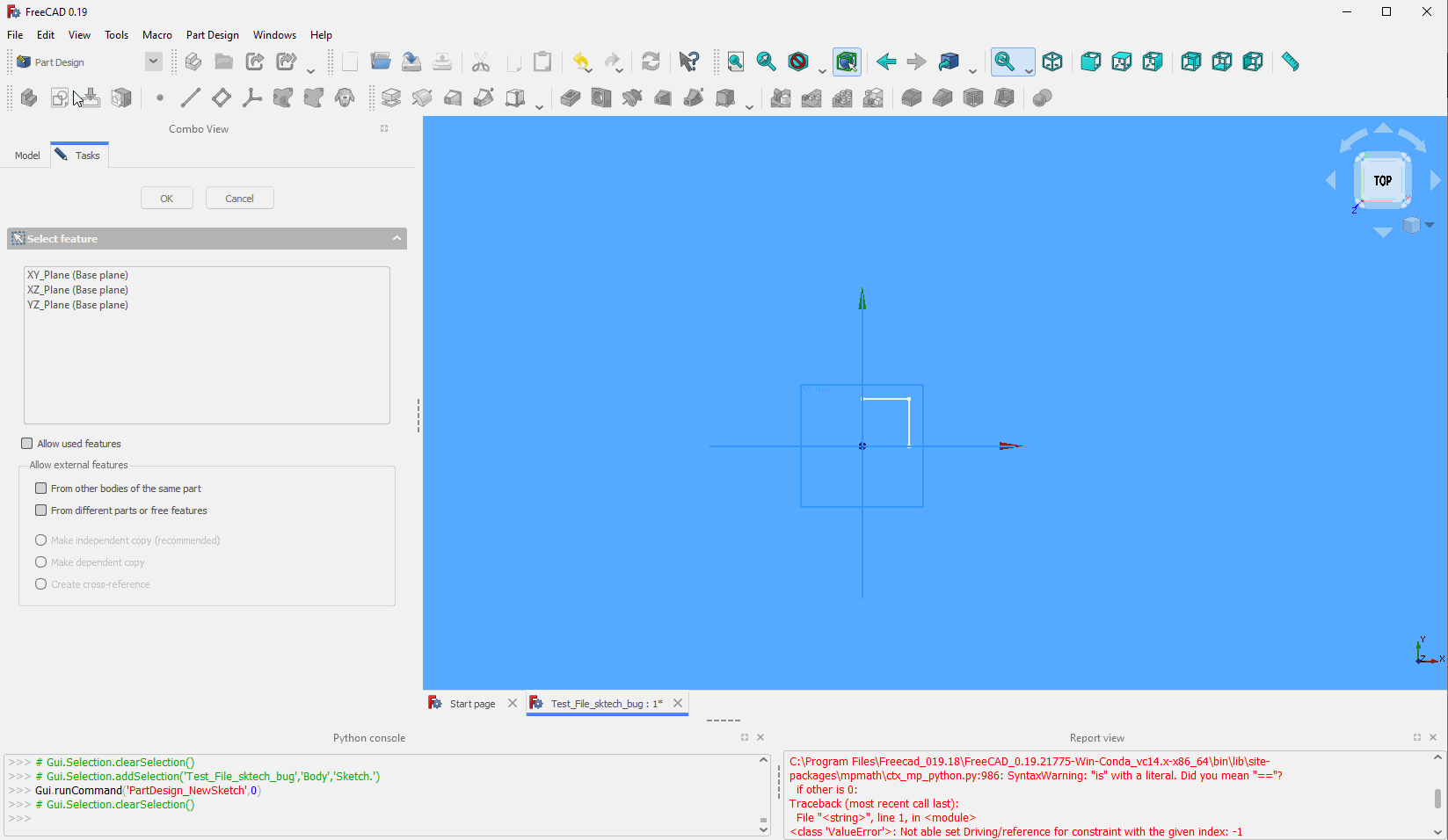

| Description | odd behavoir of the sketcher when with "lock constraint" when toggling from/to reference mode. Following setup: - make 1st sketch on xy with fully constraint sqaure - make 2nd sketch on xy and "external reference" on line on sketch 1. - toggle to reference constraint mode - lock on end point of sktech Expected behavior: two blue reference constraint Precieved behavior: two red constraints When playing further things get more mixed up... | ||||
| Steps To Reproduce | Reproducing and showing desired behaviour can be slightly simplified: Reproduce: - in second sketch create a reference to external geometry. - select an endpoint of the reference geometry - add lock constraint -> normal (red) constraints are added and correctly a redundancy error is detected. To show expected behaviour: - in second sketch create a reference to external geometry. - select an endpoint of the reference geometry - add a vertical distance constraint -> is added as (blue) driven dimension - add a horizontal distance constraint -> is added as (blue) driven dimension | ||||

FreeCAD: master bc2d3e9d 2020-10-24 14:23:43 Neinei0k Committer: abdullahtahiriyo Details Diff |
Sketcher: Fix ticket 0004399 The reason for this behaviour is that root point (origin) and axes are not treated as fixed geometry. Every external geometry has negative ID which is at most GeoEnum::RefExt defined as -3 in the file src/Mod/Sketcher/App/SketchObject.cpp. Ids of root point and axes are also defined in this file with id -1 for root point and horizontal axis, and -2 for vertical axis. To fix the problem, GeoEnum::RefExt id was replaced by root point id in the condition checking for the largest id of fixed geometry. |
