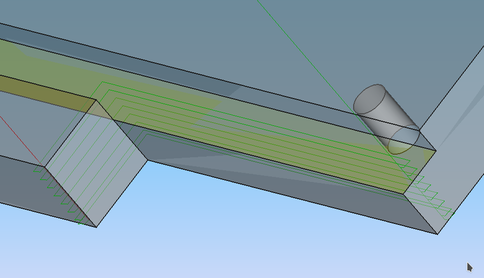

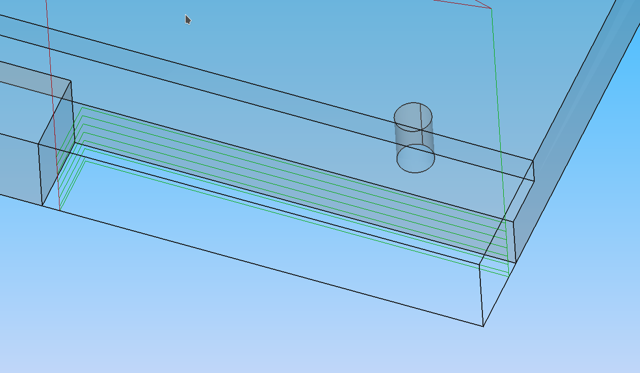

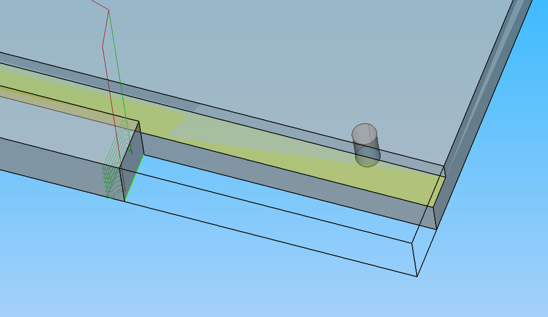

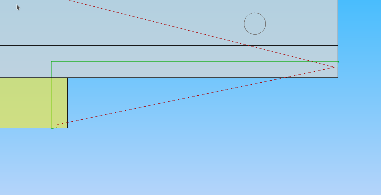

| Summary | 0004435: Wrong cut side of profil tool | ||||
| Description | Path generated by profil tool is located on the wrong side under certain circumstances. Maybe there are some rounding issues with "Final Depth". Thread with a more detailed description: https://forum.freecadweb.org/viewtopic.php?f=15&t=50172 | ||||
| Steps To Reproduce | See thread. | ||||
| FreeCAD Information | OS: Manjaro Linux (KDE//usr/share/xsessions/plasma) Word size of OS: 64-bit Word size of FreeCAD: 64-bit Version: 0.19.22443 (Git) Build type: Unknown Branch: master Hash: 3fd492fabe0868928a031507d94ff788a15286b5 Python version: 3.8.5 Qt version: 5.15.0 Coin version: 4.0.0 OCC version: 7.4.0 Locale: German/Germany (de_DE) | ||||
This behavior is not so much a bug, as a error due to improper usage for open-edge profiling. True, selection of bottom edges for combined purposes of setting geometry and Final Depth is intuitive and logical. However, due to the current implementation of the open-edge feature, it requires top edges be selected and a Final Depth to be set manually. Perhaps rethinking the approach to profiling open-edges will yield a return to the ability to select bottom edges as a means to fewer user inputs and easier, simpler usage. This requirement to select top edges is noted in the Usage section of the Profile wiki page and has been there since 15 September 2020 per wiki history. |
