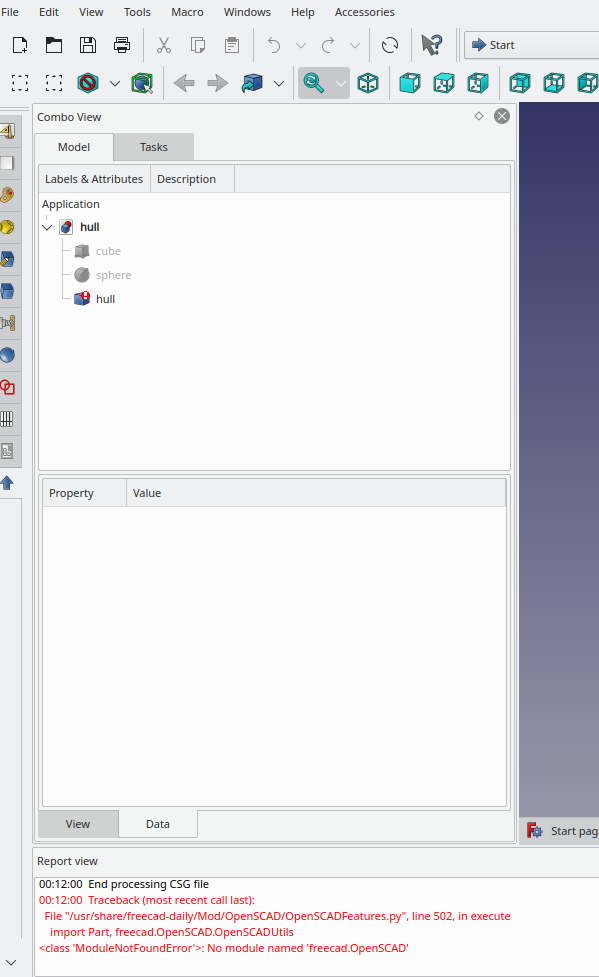

| Summary | 0004451: cant open Openscad file *.scad | ||||
| Description | if i try open some scad files with operation hull it will not successfully ended but traceback is Traceback (most recent call last): File "/usr/share/freecad-daily/Mod/OpenSCAD/OpenSCADFeatures.py", line 502, in execute import Part, freecad.OpenSCAD.OpenSCADUtils <class 'ModuleNotFoundError'>: No module named 'freecad.OpenSCAD' i fixing it by remove word freecad from thos two lines (/usr/share/freecad-daily/Mod/OpenSCAD/OpenSCADFeatures.py 502 and 503) import Part, freecad.OpenSCAD.OpenSCADUtils shape = freecad.OpenSCAD.OpenSCADUtils.process_ObjectsViaOpenSCADShape(fp.Document,fp.Children,\ fp.Operation, maxmeshpoints=maxmeshpoints) | ||||
| Steps To Reproduce | open attached file and error will appear | ||||
| Additional Information | Traceback (most recent call last): File "/usr/share/freecad-daily/Mod/OpenSCAD/OpenSCADFeatures.py", line 502, in execute import Part, freecad.OpenSCAD.OpenSCADUtils <class 'ModuleNotFoundError'>: No module named 'freecad.OpenSCAD' | ||||
| FreeCAD Information | OS: Ubuntu 20.04.1 LTS (KDE/plasma) Word size of OS: 64-bit Word size of FreeCAD: 64-bit Version: 0.19. Build type: Release Branch: unknown Hash: 7eeec7a5990cc786723225ca8de16ca3186545b3 Python version: 3.8.2 Qt version: 5.12.8 Coin version: 4.0.0 OCC version: 7.3.0 Locale: English/United States (en_US) | ||||
@mirecta : please address your issue according our reporting guidelines by opening a new topic on our forum. Thx |
Discussion thread: https://forum.freecadweb.org/viewtopic.php?f=8&t=51197 |
Can confirm that this change fixed the issue. Tested with the hull.scad file attached to the bug tracker. |
fixed with FreeCAD master f3bdaaa5 Thanks to all involved |
