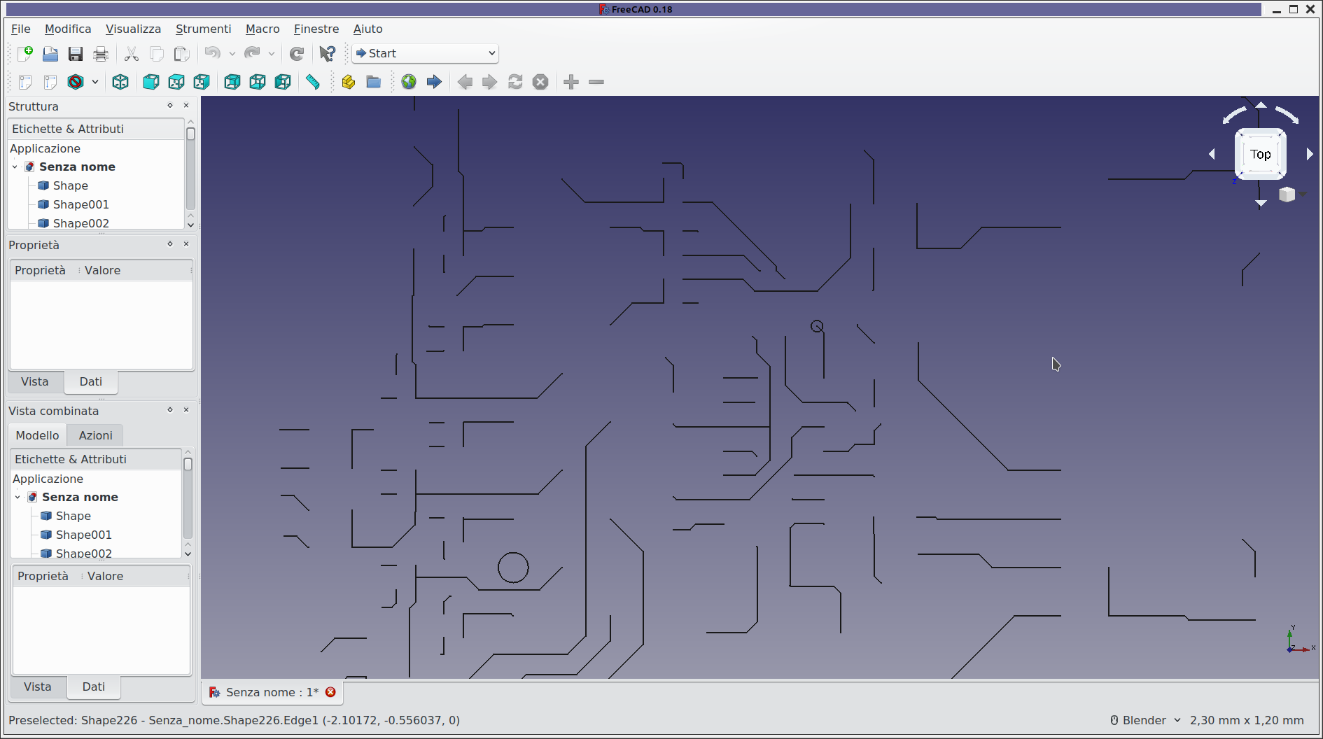

| Description | hi, the line thickness when importing DXF is wrong. The exported files become corrupt lost thickness information | ||||

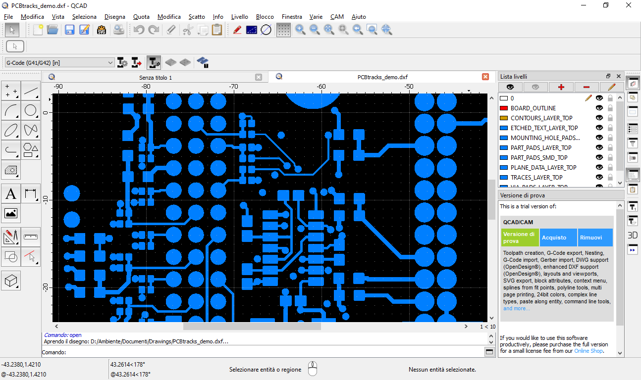

| Steps To Reproduce | Open a DXF file with line thinckness set, use the attached as test. The line property "polyline width" is not rendered Export as DXF Open the exported DXF with QCAD pro, the line thinkness is wrong | ||||
| Additional Information | the problem is present in LibreCAD and QCAD Community edition too, see: https://sourceforge.net/p/librecad/bugs/520/ QCAD Pro and Autodesk TrueView open DXF correctly | ||||

|  | see how is rendered by FreeCAD last stable on Linux: OS: LMDE 4 (debbie) Word size of OS: 64-bit Word size of FreeCAD: 64-bit Version: 0.18. Build type: Release Python version: 2.7.16rc1 Qt version: 5.11.3 Coin version: 4.0.0a OCC version: 7.3.0 Locale: Italian/Italy (it_IT) same as 0.19 on Windows |
|  | I can confirm this in: OS: Windows 10 Version 2004 Word size of OS: 64-bit Word size of FreeCAD: 64-bit Version: 0.19.23935 (Git) Build type: Debug Branch: master Hash: d5b68febbb4989b290b9af36bb2cb21d61a87a2e Python version: 3.8.6+ Qt version: 5.15.1 Coin version: 4.0.1 OCC version: 7.5.0 Locale: English/United States (en_US) The width is simply being exported as the scale, rather than whatever the value of the width was supposed to be. If you use the FreeCAD option renderPolylineWidth in the DXF import preferences settings you can get FC to try to render the line with width, but this does not fix the export issue. |
|  | on Linux, 0.19dev also with renderPolylineWidth in the DXF import active, I can't see right tickness: OS: LMDE 4 (debbie) (MATE/mate) Word size of OS: 64-bit Word size of FreeCAD: 64-bit Version: 0.19.23756 (Git) AppImage Build type: Release Branch: master Hash: 9c6e9184930a52b165a0b7274e3a45d1006bfe67 Python version: 3.8.6 Qt version: 5.12.5 Coin version: 4.0.0 OCC version: 7.4.0 Locale: Italian/Italy (it_IT) |

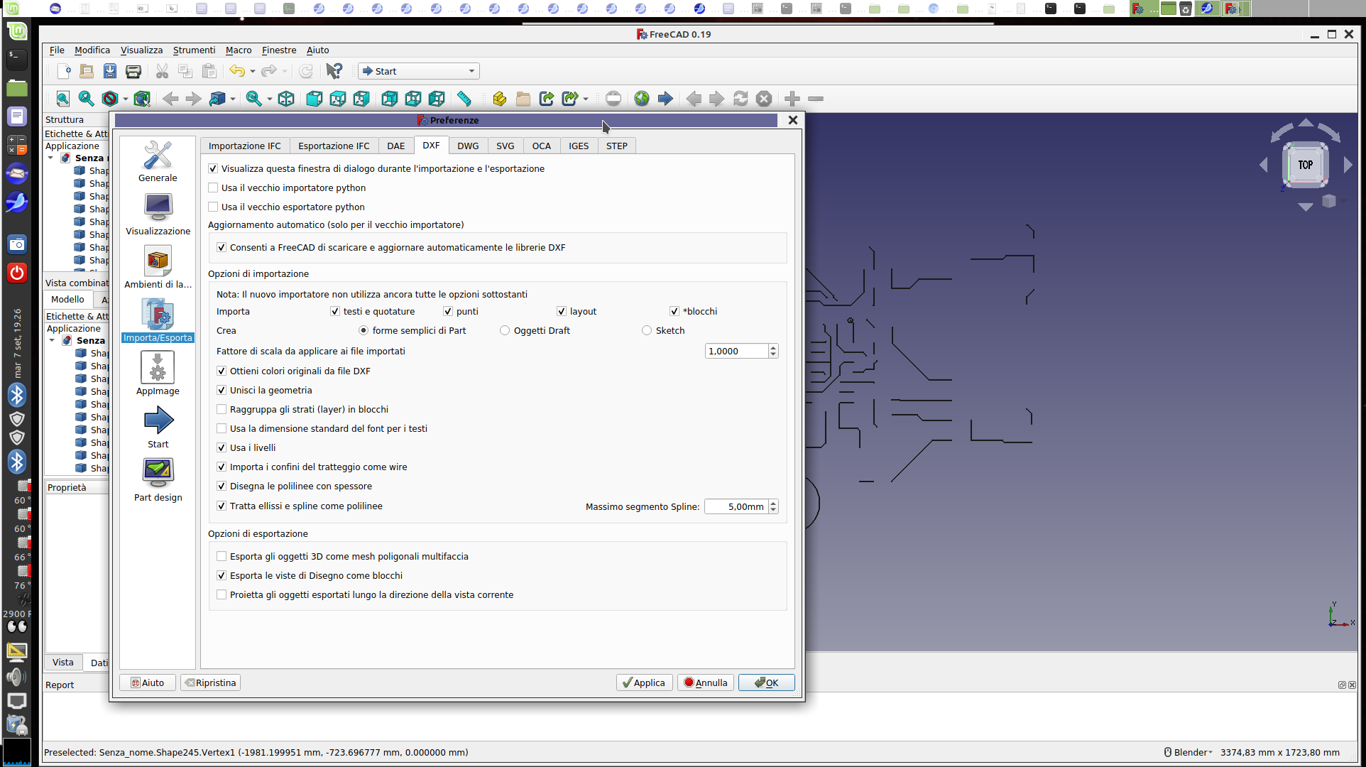

|  | it was selected "Usa il vecchio importatore python" that should be the Python Legacy Importer, I de-selected it, but the results is the same. Attached the dialog box, is there something I had to set different? |

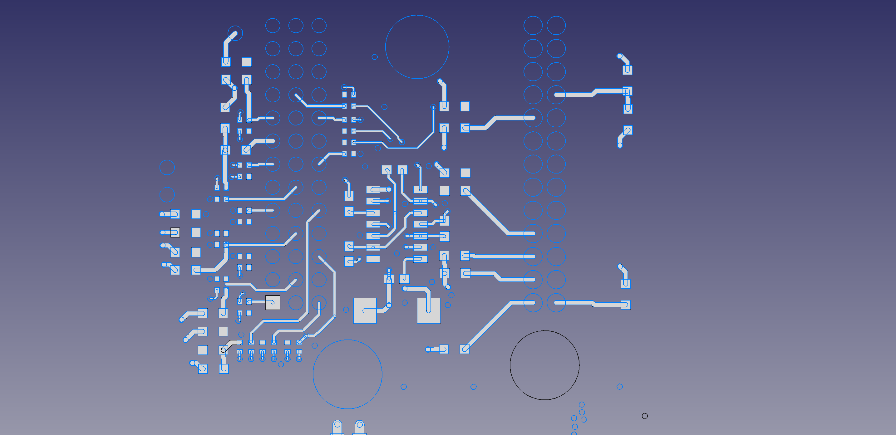

|  | You should have "Usa il vecchio importatore python" checked, but that's otherwise correct I think. When I select those options this is what I get: |
|  | OK, using the old python importer I get your output, and its lot better. Probably in the past I had selected only old python exporter |
