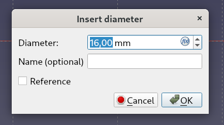

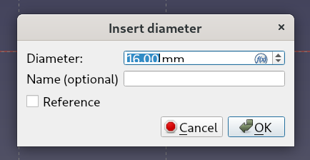

| Description | On Fedora 33 in the InsertDatum dialog the input field is too small for the text making it hard to read. I've attached a screenshot of what it looks like on my computer. Altering the height in src/Mod/Sketcher/Gui/InsertDatum.ui from 140 to 170 makes it look a lot nicer. I've attached a screenshot with the result after setting the height to 170 as well. | ||||

I assumed it looked good on other platforms since someone selected that original height value and it must look good for that person. I hoped that making the dialog a little higher it would still look good elsewhere. But let me ask in the forum for screenshots on other platforms and hopefully we can get some more data. |

Fixed by https://github.com/FreeCAD/FreeCAD/commit/ed175c9f66 |
FreeCAD master ed175c9f |
Closing ticket. Thanks to all involved! |
FreeCAD: master ed175c9f 2020-11-15 10:07:19 Details Diff |
Sketcher: [skip ci] revert minimum size hint from widgets in datum dialog because this leads to a squashed appearance on some systems. For more details see: https://forum.freecadweb.org/viewtopic.php?f=34&t=52139 |
