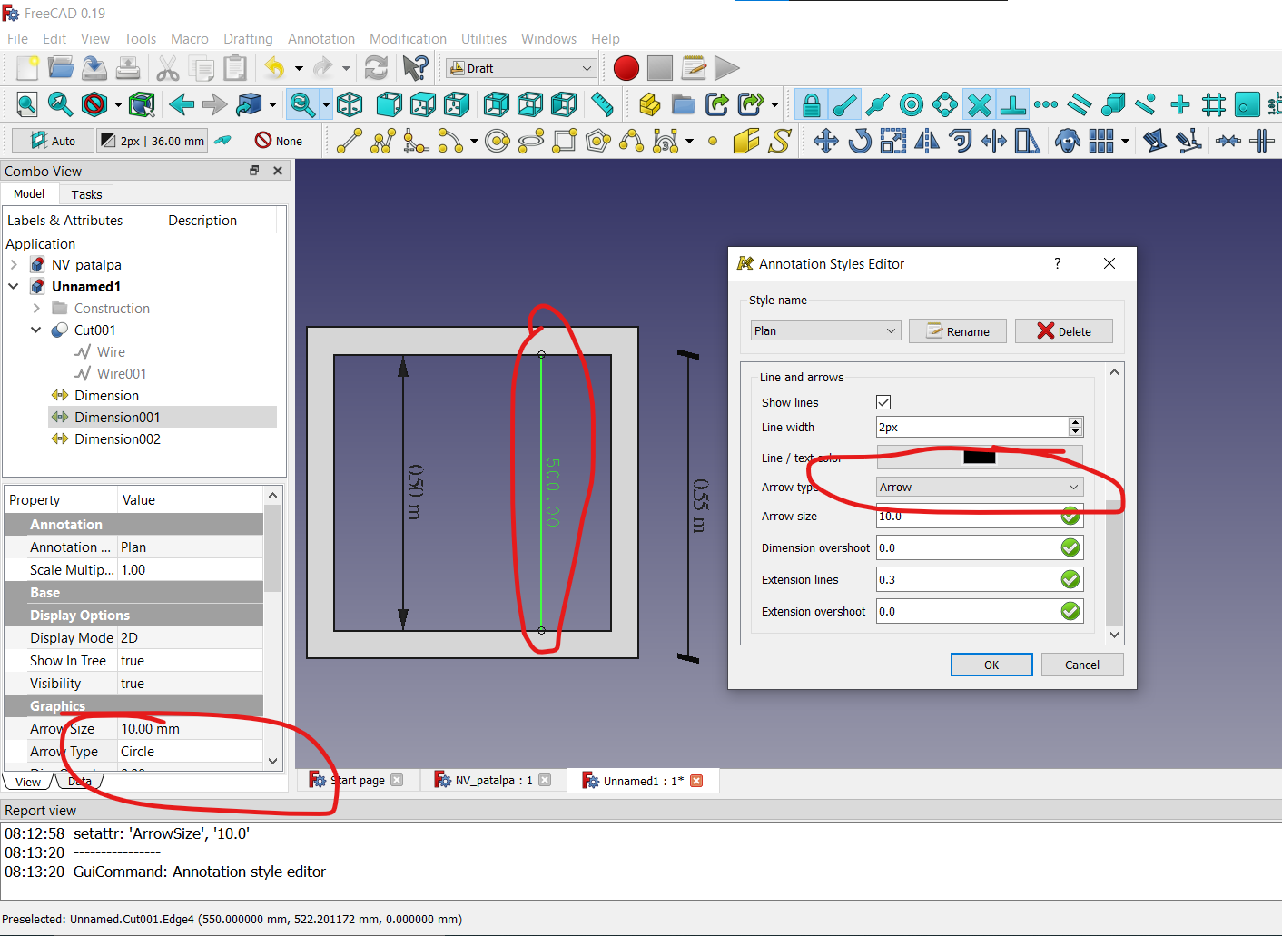

| Description | There are only 3 Arrow styles out of 5 available in Annotation styles form and Dimension styles are incorrectly being applied. It looks like there is an issue with arrow style property text values and their mapping. At the moment there is such mapping: "Dot" -> Dot, "Arrow" -> Circle, "Tick" -> Arrow. Initially reported here - https://forum.freecadweb.org/viewtopic.php?f=8&t=52554 | ||||
| Steps To Reproduce | 1. Create some objects in Draft workbench. 2. Set default arrow style in Draft workbench preferences to other than Circle (Edit -> Preferences...). 3. Create a dimension (using default preferences). 4. Create an Annotation style, set arrow style to Arrow. 5. Apply this style to the dimension. The dimension's arrow style changes to Circle instead of Arrow. | ||||

|  | Wonder why mantisbt didn't get triggered by FreeCAD master 0add97a1 ?? Edit: Probably because it hasn't sync'd yet. |
|  | Fix committed to master branch. |
|  | Yes it takes a couple of minutes before a commit appears here... |
