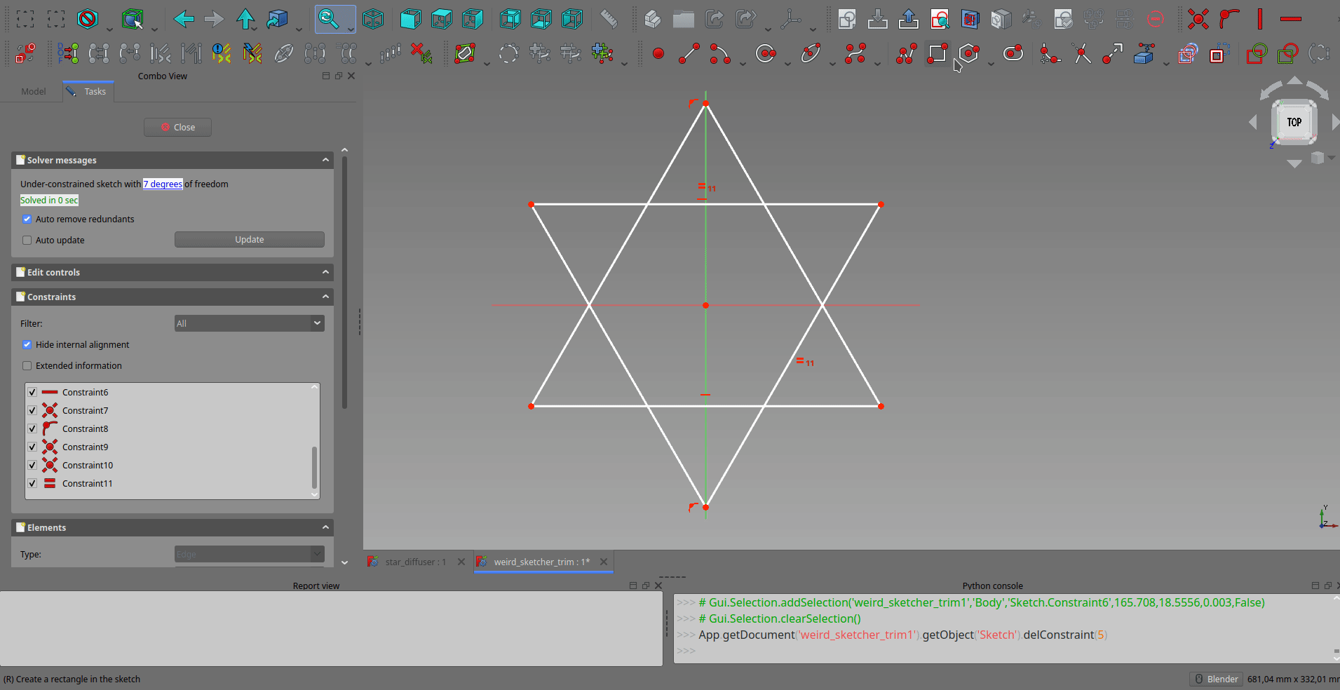

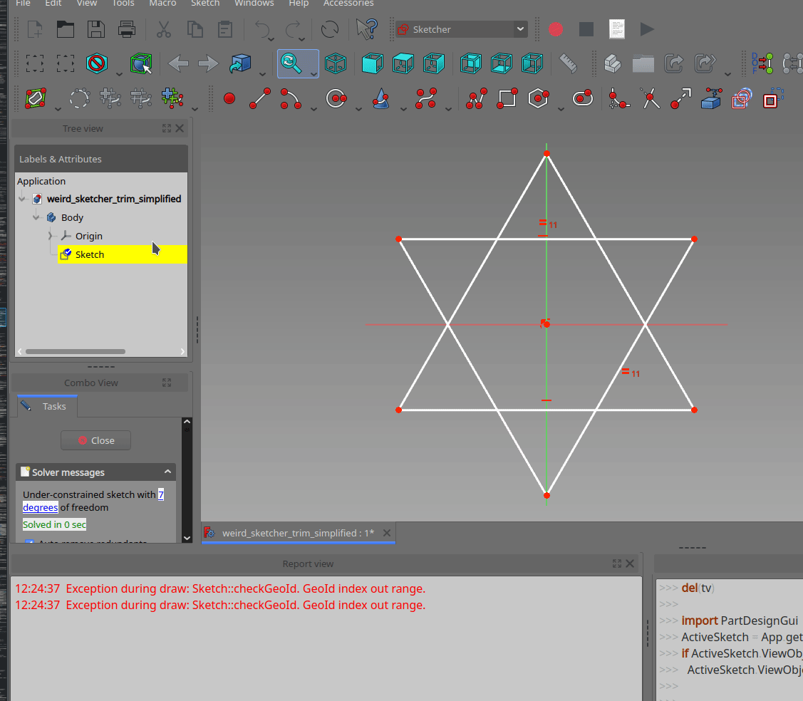

| Description | Currently trimmed edges "inherit" the Equal constraint from the original edge. This is undesirable (wrong), because the trimmed edge is always shorter than the untrimmed edge. This leads to the sketch getting distorted (as in attached gif) Forum discussion: https://forum.freecadweb.org/viewtopic.php?f=8&t=53240 | ||||
| Steps To Reproduce | 1.) Open attached freecad file. 2.) Trim the edge as in the attached gif 3.) Observe how Constraint11 is transferred to the left of the two new edges after trimming. Desired behavior is that the star shape is maintained. I.e Constraint11 should be removed as part of the trim operation. | ||||

|  | I have created a PR: https://github.com/FreeCAD/FreeCAD/pull/4147 |
|  | FreeCAD master edb87a06 FreeCAD master bfc036da FreeCAD master a8443b6b |
|  | Associated commits to ticket. Thanks to @davidosterberg @chennes and @abdullah Closing ticket |
| FreeCAD: master edb87a06 2020-12-15 11:44:19 Committer: abdullahtahiriyo Details Diff | Delete Equal constraints on LineSegments in SketchObject::trim This closes: https://tracker.freecadweb.org/view.php?id=4510 | Affected Issues 0004510 | |
