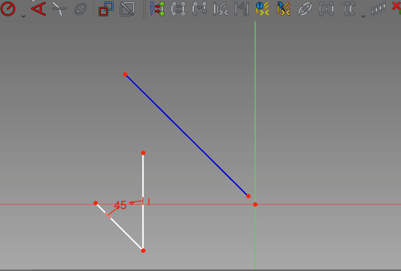

| Summary | 0004513: Sketcher mirror command incorrectly adds vertical/horizontal constraints when mirroring around non-axis aligned line | ||||

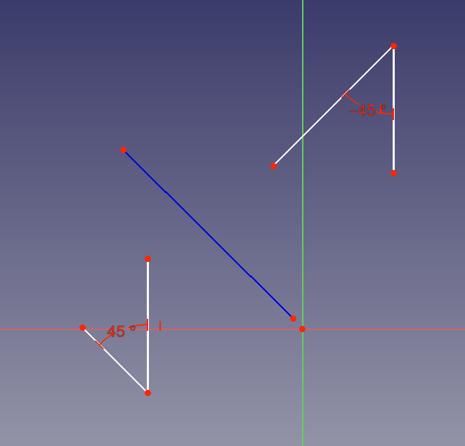

| Description | When mirroring using the mirror command inside a sketch (there seems to be another command that mirrors an entire sketch as well), the result is messed up when mirroring around a non-axis aligned line. Specifically, vertical/horizontal constraints are incorrectly copied. These are no longer valid for the mirrored copy in this case. See attached screenshot, where the upper right geometry was mirrored around the construction line. | ||||
| Steps To Reproduce | 1. Open sketch in attached file. 2. Mirror the geometry with respect to the construction line. 3. Observe that the result is not correctly mirrored, unless the vertical constraint is first removed. | ||||

PR https://github.com/FreeCAD/FreeCAD/pull/4180 |

FreeCAD: master 73fa3046 2020-12-22 10:36:27 Committer: abdullahtahiriyo Details Diff |
Sketcher: Fix issue 0004513 - SketchObject::addSymmetric This fixes issue https://tracker.freecadweb.org/view.php?id=4513 addSymmetric will now only transfer Vertical and Horizontal constraints if the reference axis is either - the HAxis - the VAxis - a Vertical line - a Horizontal line |
