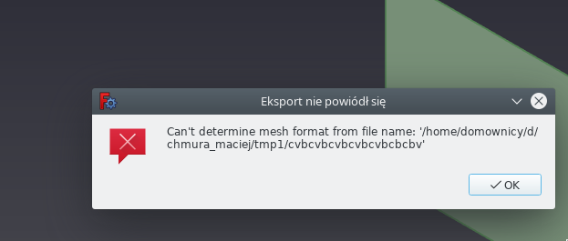

| Description | In procedure export object to file - app not add auto extension to file | ||||
@mattai can you describe the problem in more detail? What kind of file were you trying to create? Also, what version of FreeCAD are you using? In my testing the extension was added without a problem. |
I have a version problem FreeCAD_0.18-16146-rev1-Linux-Conda_Py3Qt5_glibc2.12-x86_64.appimage and FreeCAD_0.19-23578-Linux-Conda_glibc2.12-x86_64.appimage When I export *.STL. By selecting the file option or not - you have to add |
I made some changes to the export process that got merged in build 23931 ( FreeCAD master e3f88474 ) -- that was only three days ago, so this may already be fixed. When the next appimage is available can you update and give it a try? (as a side note, I see that error message is not translated... I'll look into that now.). Edit: added link to commit directly -Kunda |
I can't reproduce this bug, and the export code filename code has been refactored since the version the reporter was using. With no further contact, I'm closing this now. |
