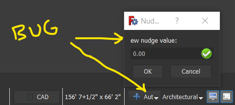

| Summary | 0004559: [BIM] Nudge tool Text obscured by overlapping arrow and Nudge Custom Value incorrectly spelled "ew nudge value" | ||||
| Description | Nudge tool Text obscured by overlapping arrow and Nudge Custom Value incorrectly spelled "ew nudge value" | ||||
| Steps To Reproduce | Overlapping arrow on text happens in any Stylesheet FreeCAD ships.Does not happen on no stylesheet. Spelling Error in Custom always happens | ||||

chennes identified the bug in https://github.com/yorikvanhavre/BIM_Workbench/blob/7abea63e57aaedc10e64a543766b59a4b426800a/dialogNudgeValue.ui#L20 |

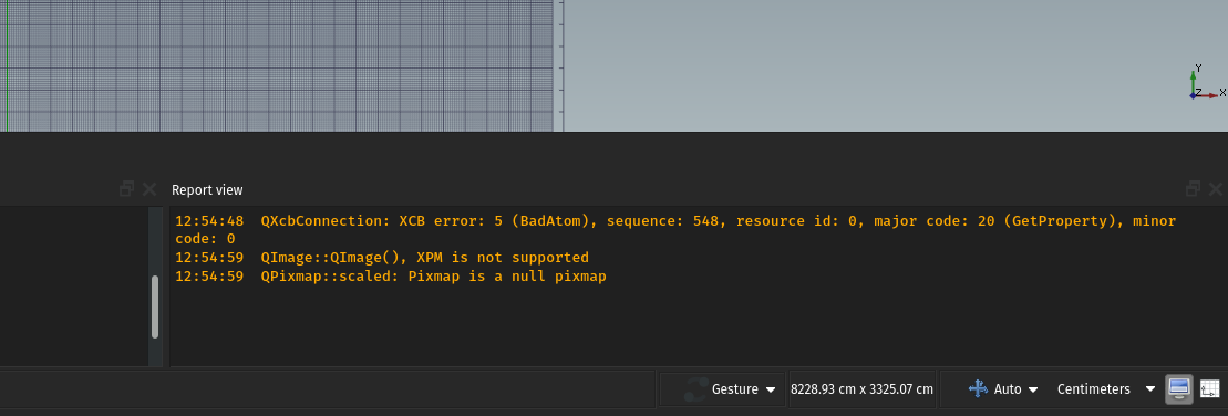

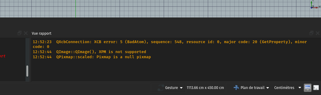

The first issue ("ew"->"New") is solved with https://github.com/yorikvanhavre/BIM_Workbench/commit/52e65ee3864a9ff7bcb64844ba2d3732ca5b1720 As for the second issue, I can't reproduce it here, the button takes the size that it needs automatically. Can anyone else confirm or infirm? |
Maybe a Windows only bug. Can Reproduce with any stylesheet FreeCAD ships with. No Stylesheet it is fine. OS: Windows 10 (10.0) Word size of OS: 64-bit Word size of FreeCAD: 64-bit Version: 0.19.23756 (Git) Build type: Release Branch: master Hash: 9c6e9184930a52b165a0b7274e3a45d1006bfe67 Python version: 3.8.6 Qt version: 5.12.5 Coin version: 4.0.0 OCC version: 7.4.0 Locale: English/Canada (en_CA) |
Can reproduce bug on Linux also. Bug is only produced when any FreeCAD stylesheet is applied. No stylesheet no bug. Could be related to https://forum.freecadweb.org/viewtopic.php?p=99677#p99677 |
Then it's likely a stylesheet bug, not a BIM WB bug. Probably the stylesheets give a max width value to these statusbar buttons. I'll have a better look |

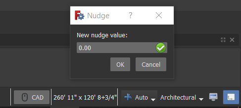

I fixed the issue on my ProDark Theme https://github.com/turn211/ProDark-FreeCAD-theme/blame/655292a6e3e3791c3c72657689c3766fb1011e74/ProDark.qss#L1918 QToolBar > QPushButton:!checked { background-color: #333333; /* Current Working Plane and Nudge */ border: 1px solid #333333; text-align: left; If someone can add text-align: left; to all the shipping Stylesheets this bug would be squashed. |
Thanks @turn211 Please verify fix: FreeCAD Pull Request 4448 |
@yorik please merge, thanks |
Also sent PR to upstream Behave-dark repo https://github.com/Chrismettal/FreeCAD-Behave-dark/pull/5 which was merged |
Fix committed to master branch. |
Thanks @turn211 for the fix. FreeCAD master 518a9fcb Darn sourceintegration plugin isn't closing tickets. Closing manually. |
