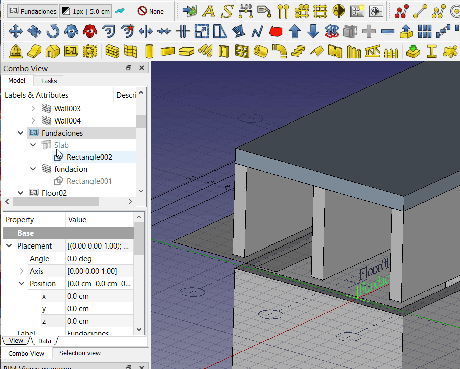

| Summary | 0004562: Active working plane changes when I close Draft Edit panel | ||||
| Description | Active working plane proxy changes to other proxy when I close Draft Edit panel. Forum discussion: https://forum.freecadweb.org/viewtopic.php?f=23&t=54519 | ||||
| Steps To Reproduce | 1) Working Plane "Fundaciones" is active (see attached file). 2) Select Rectangle002 object. 3) Double click on Rectangle002 object or Draft Edit command for Rectangle002 4) Click on close button in the panel task. 5) The working plane active will change to another working plane (Floor002). | ||||
