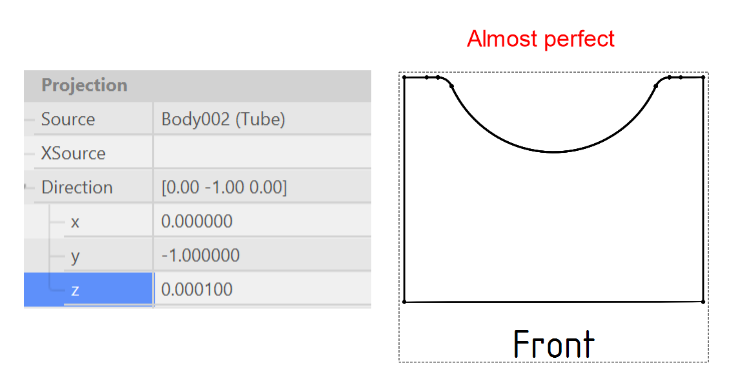

Open the drawing page and set the Front projection direction to X0, Y-1, Z0.000000
FreeCAD hangs while generating the view and has an excessive number of vertices when complete.
Set the projection direction to X0, Y-1, Z0.000001
The view is now missing lines.
Set the projection direction to X0, Y-1, Z0.000100
The view is now almost perfect.

is there a connection with 4639? Overlapping lines not drawn??
wandererfan
2022-01-10 13:19
manager   ~0016199
The missing short lines seem to be a bug in OCCT. The number of vertices is appropriate for the projected BSpline.
