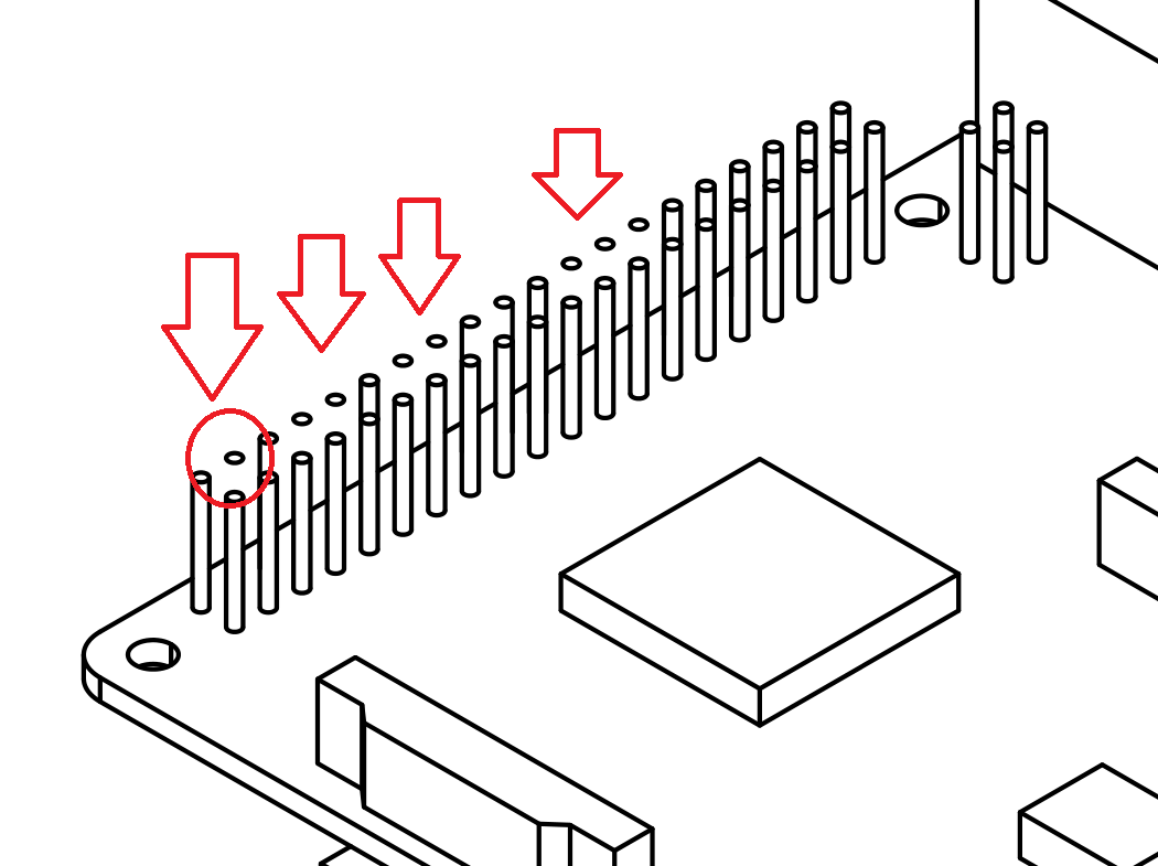

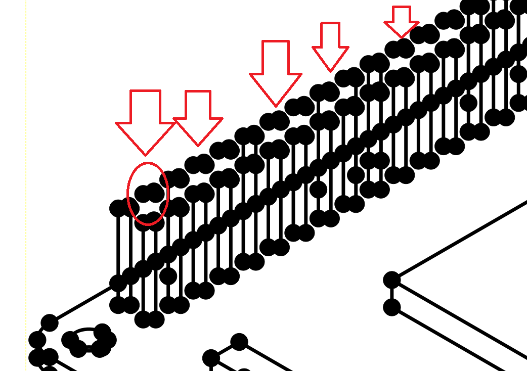

Summary0004639: TechDraw not drawing all lines in view
DescriptionTechDraw is missing some lines in the isometric view
Steps To Reproduce1. Open the attached file raspberry_pi_4b.FCStd
2. Open "Page" item in the tree browser
3. Look at the isometric view.
4. Notice some of the 40way header pins are missing vertical lines, as shown by the attached images.

Some of the overlapping vertical lines for the pins are being treated as "hard hidden" instead of "hard visible". Only part of the edge is hidden - does OCC not split the edge into visible and invisible portions before classifying??

is there a connection with 4564 short and/or overlapping lines not drawn??

using the perspective projector with a long focal length shows all the lines (also gives a better result for 4564).
this has come up before, but I can't find an upstream ticket.
