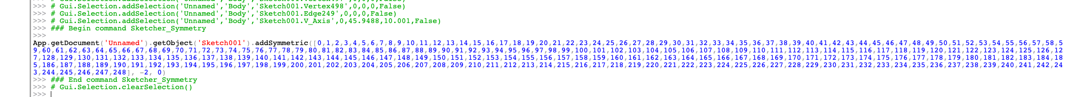

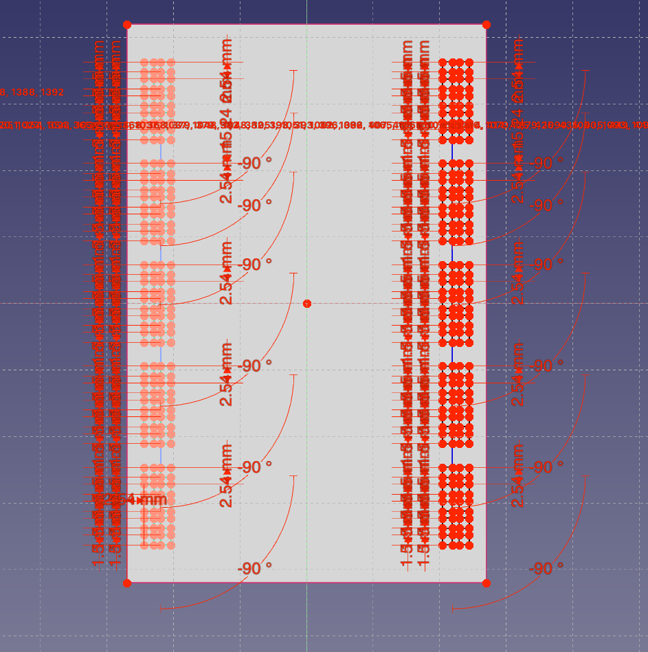

| Description | I have been trying to make a complex pattern - the holes in a breadboard. I have a face and sketching on the face, I create first a construction line 4.5mm from the side of the board. I then made a 1.5mm square. I created a pattern of 2 x 5 of these, at 2.54mm separation. I used the symmetry tool to place the 2 columns on either side of the construction line. Making sure the angle was good and that it made sense, I then attempted to create a pattern of 5x1 f these 2x5 blocks. I had made a number of attempts to get the parameters correct - 4 or 5 attempts to adjust and then undo loops to get the style I wanted. However, at the last undo, FreeCAD crashed. | ||||
| Steps To Reproduce | * Make a pattern in sketch mode - with multiple columns. * Make a further pattern of these patterns. * Adjust these - lengths, and angles. * Undo a retry with different row/column counts. * Attempt to recreate the patterns. | ||||

Build: OS: macOS 10.16 Word size of FreeCAD: 64-bit Version: 0.20.25311 (Git) Build type: Release Branch: master Hash: c5524bb58a7126fa2242d6137eb82ee9d54e82d4 Python version: 3.9.6 Qt version: 5.12.9 Coin version: 4.0.0 OCC version: 7.5.2 Locale: C/Default (C) Steps taken: * Part Design * New part * Sketch - XY Plane. * Create rect - consider it the outer rect for this sketch * Use the symmetry constraint - horiz/vertical. * Shift-D constrain both (let's say 54mm by 84mm for example). Should be fully constrained. * Close sketch and Pad this 10mm. * Select top surface, then tasks, create sketch. * Create external geom references to the four edges. * Create a further rect - make it 2mm on the vertical left. Make other edge equal. * Select the 4 edges of this shape. * Create array -> 5 x 2 - drag 90 degrees. It won't be spot on, so double click the angle - set to -90. Select the distance, and set it to 2.54mm. * This is where I perform an undo step - since 2mm would be too large. Undo until there's no array - just the rect. * Set the rect edge to 1.5mm. * Reseelect, create 5 by 2 array. Reset -90 and 2.54mm. * Select the existing array. Now we create a further array of these. we want a 5 x 1 array, still at -90 ish. * Set the distance for the second array to 6.54mm apart. This won't give quite the right result. Ctrl -z and redo as 6 * 2.54mm. * Set the angle to exactly -90. FreecCAD will start feeling slow at this point. * Find the two middle rectangles. on the left-most edge, select the two points, and the horizontal centre line - perform a symmetry constraint. This will take some time to resolve. And didn't behave as expected (that rect had moved, with the whole reference group moving, but not by the same amount). * ctrl-z to undo. Try a top and bottom point - and perform symmetry with them. Again - this will take some time to resolve. And still be wrong - ctrl-z and wait. * Try top and bottom of middle set... result is still wrong, and it took ages to resolve. Good news - I don't seem to be making it crash - but it is slow and not creating the symmetry I expect. * I finally get it symmetrical by selecting the middle rectangle of the second column in the middle array. * Create a dimension - 2.54mm horizontal to the one of the left edge points. * Select the whole array (Freecad will stall here) - mirror around the vertical centre line. Long time - but no crash. The view is pretty cluttered - but it's still alive. * To enforce the mirror - select the rightmost top point of the left array, and the mirror point on the right array, then the vertical centre line. Add a symmetry constraint. Takes a while - but succeeds. * The sketch seems under constrained - so use the under-constrained to see where the problem is, and on this basis, make a symmetry constraint for the points of the middle box of the right array to match the symmetry constraint on the left array - this constraint didn't get mirrored. Should be fully constrained. Cut this into the original shape 5mm. It' looks like I can't reproduce the crash. We can close this. |
@orionrobots, is there any reason you want to make a pattern in sketcher rather than trying to make a pattern of the pocket made from just one rectangle? That might be able to make your life a little easier. We should move this discussion to the forum. |
