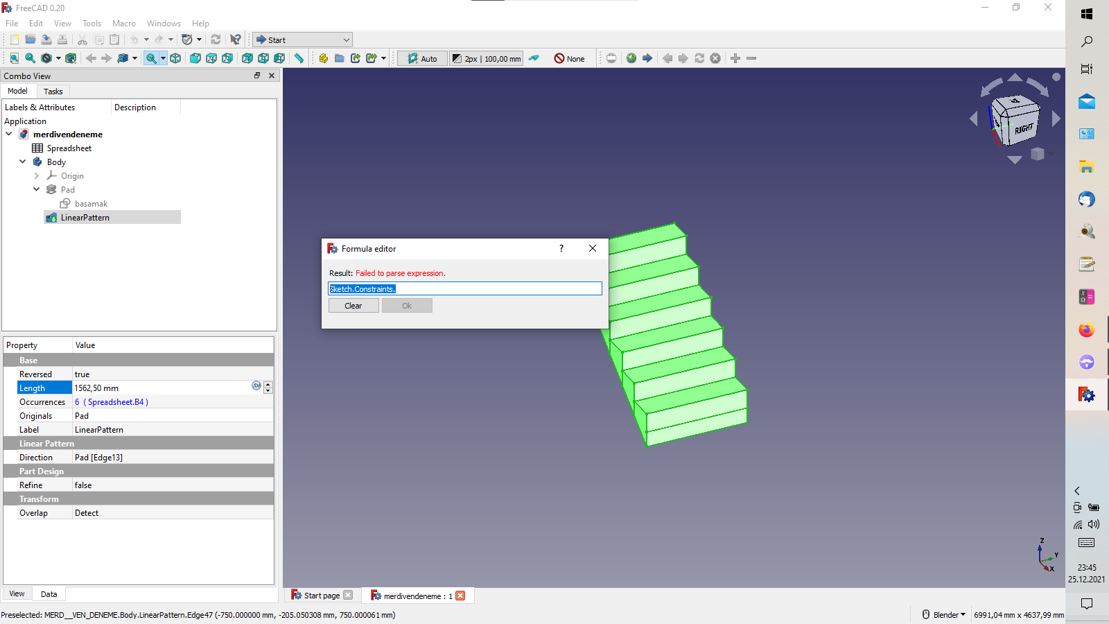

| Summary | 0004813: Sketch.Constraints.XX expression not working. İ cant carry the Sketch.Constraints data to other sketch. | ||||

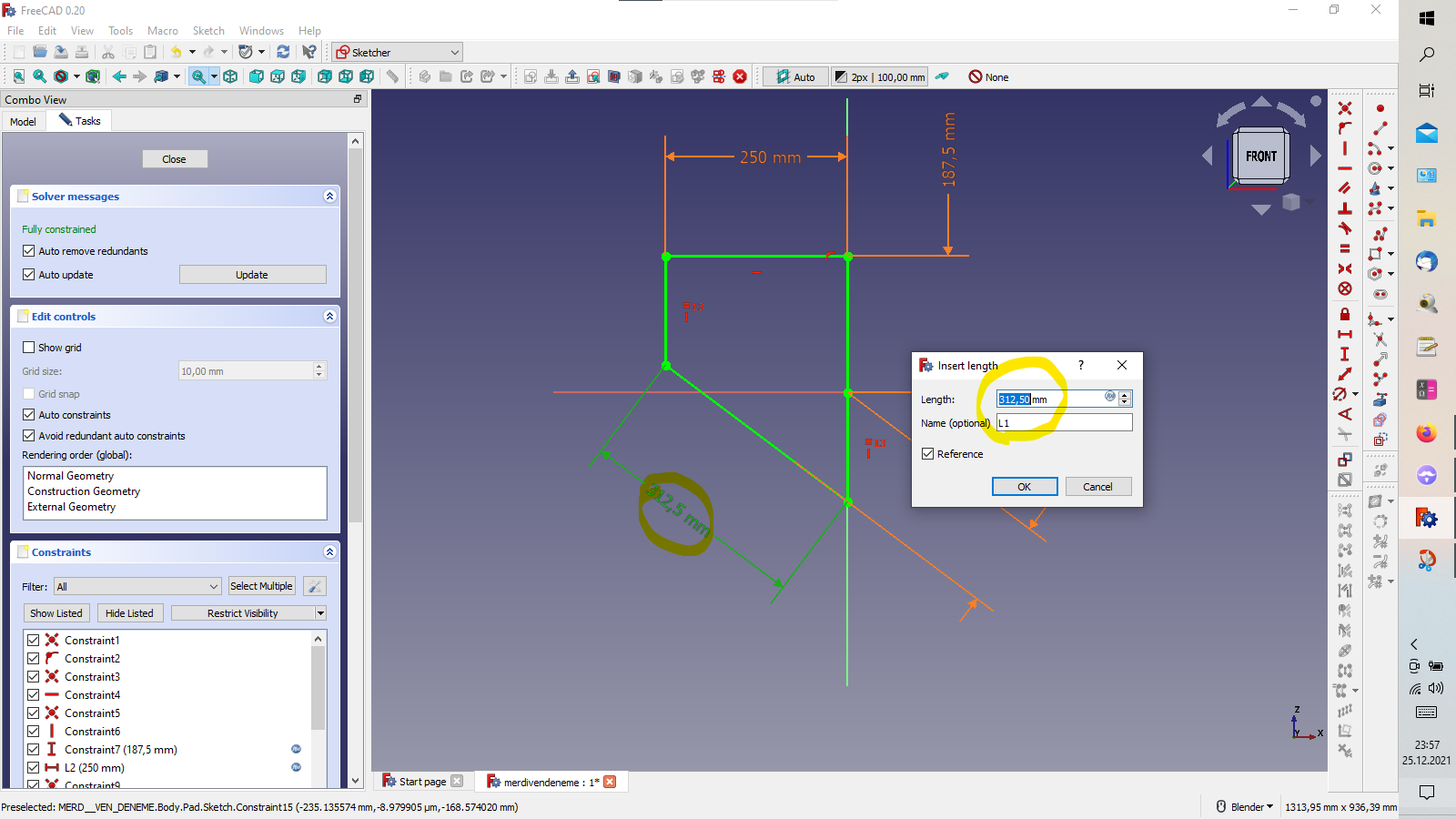

| Description | OS: Windows 10 (10.0) Word size of FreeCAD: 64-bit Version: 0.20.26761 (Git) Build type: Release Python version: 3.8.12 Qt version: 5.12.9 Coin version: 4.0.0 OCC version: 7.5.3 Locale: Turkish/Turkey (tr_TR) 1 i opened partdesign wb 2 create e body and enter the sketch. 3 draw a stair section and add to Constraints 4 i attached a Optional name to Constraints for example "L1" 5 i Closed sketch 6 i gone to other future and open expression dialog box 7 i entered Sketch.Constraints.XX but not call that constraints. 8 it is not worked 9 That is working probably on FreeCad 019 | ||||

This is the AutoComplete for sketcher constraints not working from the attached images. If the correct constraint name is typed by hand everything works. OS: Windows 8.1 Version 6.3 (Build 9600) Word size of FreeCAD: 64-bit Version: 0.20.27157 (Git) Build type: Release Branch: master Hash: 48f07429a2483e7825c6bb9daefa77abec5740b9 Python version: 3.8.8 Qt version: 5.15.2 Coin version: 4.0.1 OCC version: 7.5.3 Locale: Bulgarian/Bulgaria (bg_BG) |
Fixed in 0.20.27078 |
