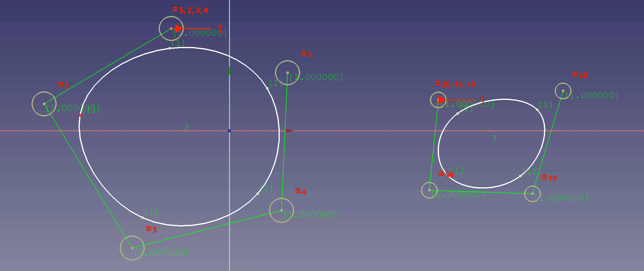

| Description | Hello, I hope I did not mix something up in the settings, but my Periodic B-Splines are not closing properly anymore and I suspect it has to do with the latest daily update. Any Periodic BSpline I create leaves the last member of the control polygon out, as in the picture. I cannot use the sketch anymore, while the sketch then has missing coincidences... | ||||
| Steps To Reproduce | Make a new sketch and insert a periodic BSpline. | ||||
| FreeCAD Information | OS: Ubuntu 20.04.3 LTS (ubuntu:GNOME/ubuntu) Word size of FreeCAD: 64-bit Version: 0.20. Build type: Release Branch: unknown Hash: 39ed257eb4b59ae72ef9522d1d6c6ba886f8222f Python version: 3.8.10 Qt version: 5.12.8 Coin version: 4.0.0 OCC version: 7.5.2 Locale: C/Default (C) | ||||
Please suspend this issue report, I'm not sure it's actually a bug and will first ask on the forums. |
@louisgag please x-post the forum thread to this bug so we can track the outcome. |
had to re-open to post the forum link: https://forum.freecadweb.org/viewtopic.php?f=10&t=65670 |
Abdullah pushed fix in https://github.com/FreeCAD/FreeCAD/commit/7aefd2366f182c09683fc696f38c6a57c1b8fa15 Closing ticket. |
