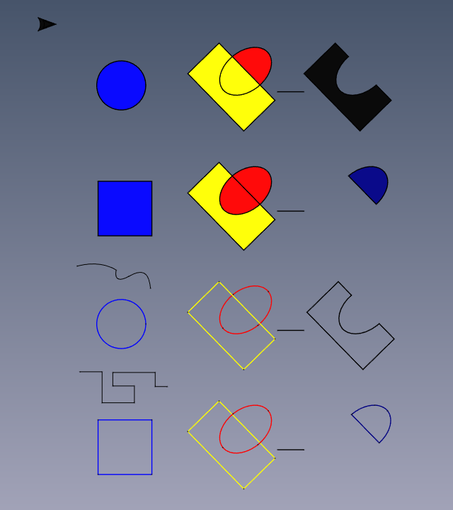

| Summary | 0002488: Standard paths issues from import SVG to FreeCAD | ||||
| Description | http://forum.freecadweb.org/viewtopic.php?f=3&t=15093 | ||||
| Tags | #pending-forum, Inkscape, SVG | ||||
| FreeCAD Information | |||||
| related to | 0003355 | closed | File formats | SVG importer: regression from 0.16 to 0.17 |
This is a complex problem, the different ellipse segments are correctly read and rendered by FreeCAD, the difficulty is to turn them into a wire, probably becasue some precision issue occurs. I did a partial fix in 60d6a2149 but there is more needed. In any case this is not a critical issue as it concerns a very specific file, so I don't think we need to keep it as a 0.18 showstopper. |
Bumped forum thread https://forum.freecadweb.org/viewtopic.php?p=563255#p563255 |
I just tried again with the above svg file, and results look good to me. I think this issue can be closed |

| 2022-01-20 12:31 | yorik | Note Added: 0016236 | |
| 2022-01-20 12:31 | yorik | File Added: Screenshot from 2022-01-20 13-06-48.png | |
| 2022-01-20 12:32 | yorik | Status | assigned => closed |
| 2022-01-20 12:32 | yorik | Resolution | open => fixed |
| 2022-01-20 12:32 | yorik | Fixed in Version | => 0.20 |
